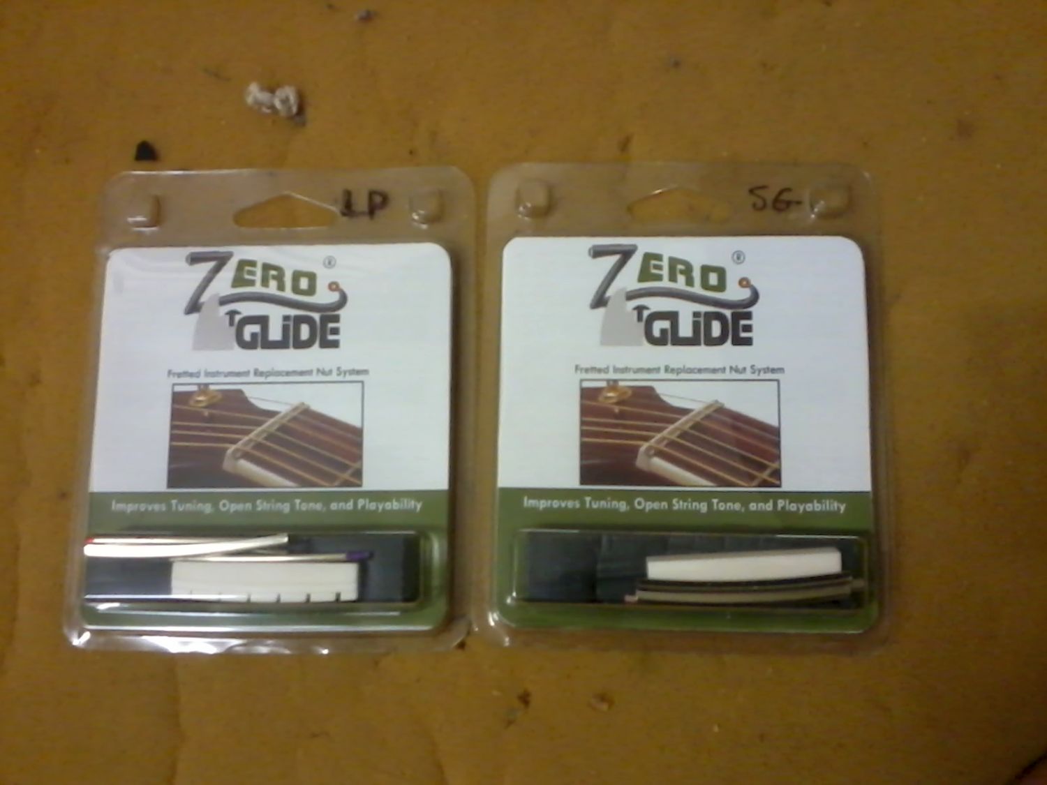

    Recently, I ordered a couple of Zero Glide nuts to replace the Tusq XL nuts on my LP Studio and Angus SG, I picked them up from the post office this afternoon and I finally have them here at home with me so I can start working on installing them, here's a pic so you can see what they look like:
Name:	Zero Glide Nuts_resized.jpg
    These Zero Glide nuts are not your ordinary nuts, they are specially designed for adding what's called a Zero-Fret to a guitar fingerboard, okay so what's so special about that?, from what I've read a Zero Fret offers some advantages over a traditional nut, firstly, with a Zero Fret you no longer have to go through the process of filing nut slots in a nut to the correct depth and shape to get a buzz-free 1st fret action since the Zero Fret automatically sets the 1st fret action correctly for all strings, have you ever tried putting a capo on your guitar just behind the first fret and wondered why the action is suddenly much better for fretting notes?, that's because the first fret is now acting like a nut, the Zero Fret does the same thing.
    The other advantage I see is that because the nut slots only keep the strings spaced evenly behind the Zero Fret, you don't get any of that annoying Sitar-Buzzing that traditional nuts can suffer from, the Zero Fret does two jobs at once, it accurately defines the zero-point on the scale length, plus it also sets the 1st fret action, because the string rests on the Zero Fret the energy from the vibrating string gets transferred into the wood better, so open strings should sound virtually identical to fretted notes, once the Zero Glide Nut has been installed on my Angus SG I'll do a new recording for you so stay tuned.

    Awesome post DrNomis!,,,I have a question for you. I am about to buy a Chibson Les Paul and instead of dealing with shitty parts that I'm gonna replace anyway and whacky Chinese non-USA metrics, I am just going to send them: a REAL Tuna-O-Matic bridge and tailpiece, grover locking tuners and a Graph Tech Tusq nut for them to install as they build it.
    Did the Graph Tech XL Tusq for real Gibsons fit perfectly on your Chibson or will I need to buy a different size nut?
    ...and any other advice you can give me would surely be appreciated!
    Thank you, Ian
    Quote Originally Posted by ianpoet View Post
    Thank you, Ian
    Hi Ian,
    Since the Zeroglide Nut was a bit over-size, I had to do quite a bit of sanding to get the nut to fit the nut-shelf on my Chibson SG properly, if my memory serves me right, I had to sand-off about 2mm or so from the back of the nut to get it to fit, I also had to sand quite a bit off the ends of the nut because it was a bit to long to fit the neck width, so it's not really a drop-in replacement without some modification to the nut itself, personally I was a bit underwhelmed by the results I got after I had fitted the Zeroglide nut, although it fixed some issues with the original nut, it actually made the tuning-stability of the guitar worse rather than better, contrary to what the maker of the Zeroglide Nut claims, I would put that down to two factors, the softness of the metal used to make the pieces of fretwire included with the Zeroglide nut itself (they really should be made out of something harder, like stainless steel, so that the string doesn't prematurely wear a groove in them which causes tuning stability issues from the resulting friction), and the back-angle of the headstock causing too much downward pressure on the zero-fret.
    You might get better results with a properly cut and fitted bone nut, I installed a Zeroglide nut on my LP Studio guitar but ended up getting it replaced with a properly cut and fitted Bone nut which I think works much better, the extra bit of money spent to get a Luthier to cut and fit a Bone nut to your Chibson guitar is well worth it even though it may cost a bit.
    I have to be honest with you, looking back, I'm a bit underwhelmed by the build quality of my Chibson SG, the neck pickup is not quite centred properly and there's a raised fret causing some issues with fret-buzzing that needs addressing, the guitar has some other issues that needs addressing too, I may see if I can fix them later on this year, maybe you might get a guitar that exhibits better build quality though, also there are some legal issues with buying one of these Chibson guitars since the makers of these guitars are actually committing offenses under copyright laws, hence the reason why you hear about a lot of Chibson guitar buyers complaining that their guitars got confiscated by US Customs after being imported, have you considered buying a PBG LP kit instead?
