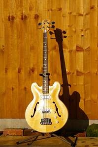

    Sunny this morning - about the first time for weeks...

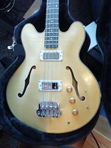

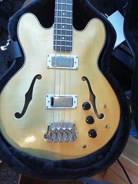

    Black knobs,
    Amber knobs,
    or White knobs?

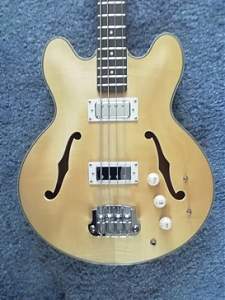

    Although having persuaded (thanks Simon for the hint to check the spline count) the not especially well moulded amber knobs on the pot shafts I'm not sure that the pots would survive them being taken off again...
    I'm not quite sure between white and amber, but the fact that I'd need to buy a new set of white ones since those need to go back on the Strat might be a clincher...
    Build #4, pre-owned PB ESB-4
    Build #5, Lockdown Mandolin
    Build #7, Mini Midi Bass
    3,048
    This really looks great! I agree about not using the black. The amber ones look very good. It's a close thing between the white and the amber. That said, I have had once pulled the entire shaft out of pot trying to get the knob off. That's one of the reasons I try to use only solid shaft pots and knobs with set screws. Unless you're unhappy with the amber knobs I'd leave them.
    It can be confusing picking knobs. Part of it is there is no one way to talk about them... "fine spline," "USA spline," "CTS spline," and "24 spline" all mean the same thing. "Course spline," "18 spline," and "Asian spline" all mean the same thing too. Anything with a set screw, is, of course, for a solid shaft, although I like set screw knobs so much better that I have some inserts to use with splined pots to adapt them for solid shaft knobs. There are also knobs that have a soft enough insert to take either kind of splines... You might get away with putting a fine spline knob on an asian pot, but the other way around will generally not work. I have a broken knob to prove it.

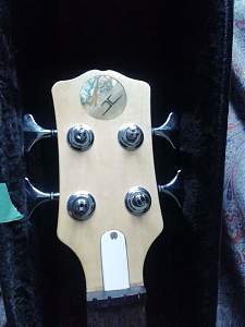

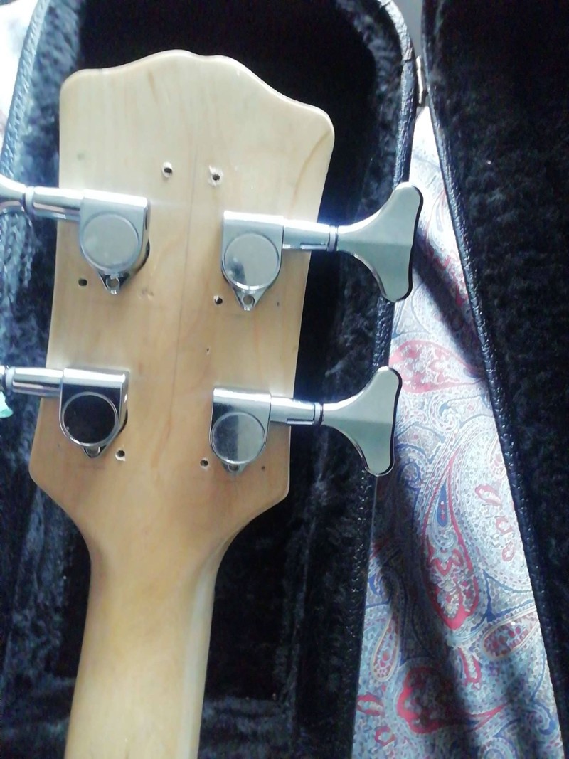

    Smaller tuners - now it fits in the case.
    These are own brand Stentor in the UK, but are made in Korea by Jin Ho and appear to be these: : http://www.jinhomusic.com/bass/jb_150.html
    They are pretty much impossible to distinguish between the OEM tuners on my Ibanez acoustic bass, and could well be the same.They seem decent enough so far, I can't detect back lash off the guitar.
ID:	32932 Click image for larger version.
    Unfortunately they don't quite cover the holes drilled for the standard tuners, and even the washers are too small to cover the hole, so they are sitting on the ferrules for the stock tuners which they actually mate well with. I'm going to try just wood filler for the tuner holes. Its such a small gap hopefully it won't show too much when its been sanded flat and given new coats of tru oil.
