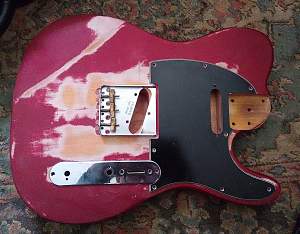

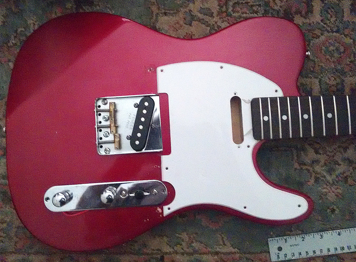

    As Build no:2 has reached completion.
    ...and no:1 is in hiatus awaiting finalising fretboard radius.
    My attention is now back on no:3.
    Call it OCD or whatever but I am not satisfied that the dimensions are not a standard Tele.
    Therefore, I am going to take the next colour change opportunity to put this right.
    The white pick-guard is standard issue Telecaster and the control plate/bridge assembly as you can see is out.
    It will mean some more sanding and wood surgery.
    Also have a 22 fret Kmise tele neck coming.
    Undecided about the colour so far.
    cheers, Mark.

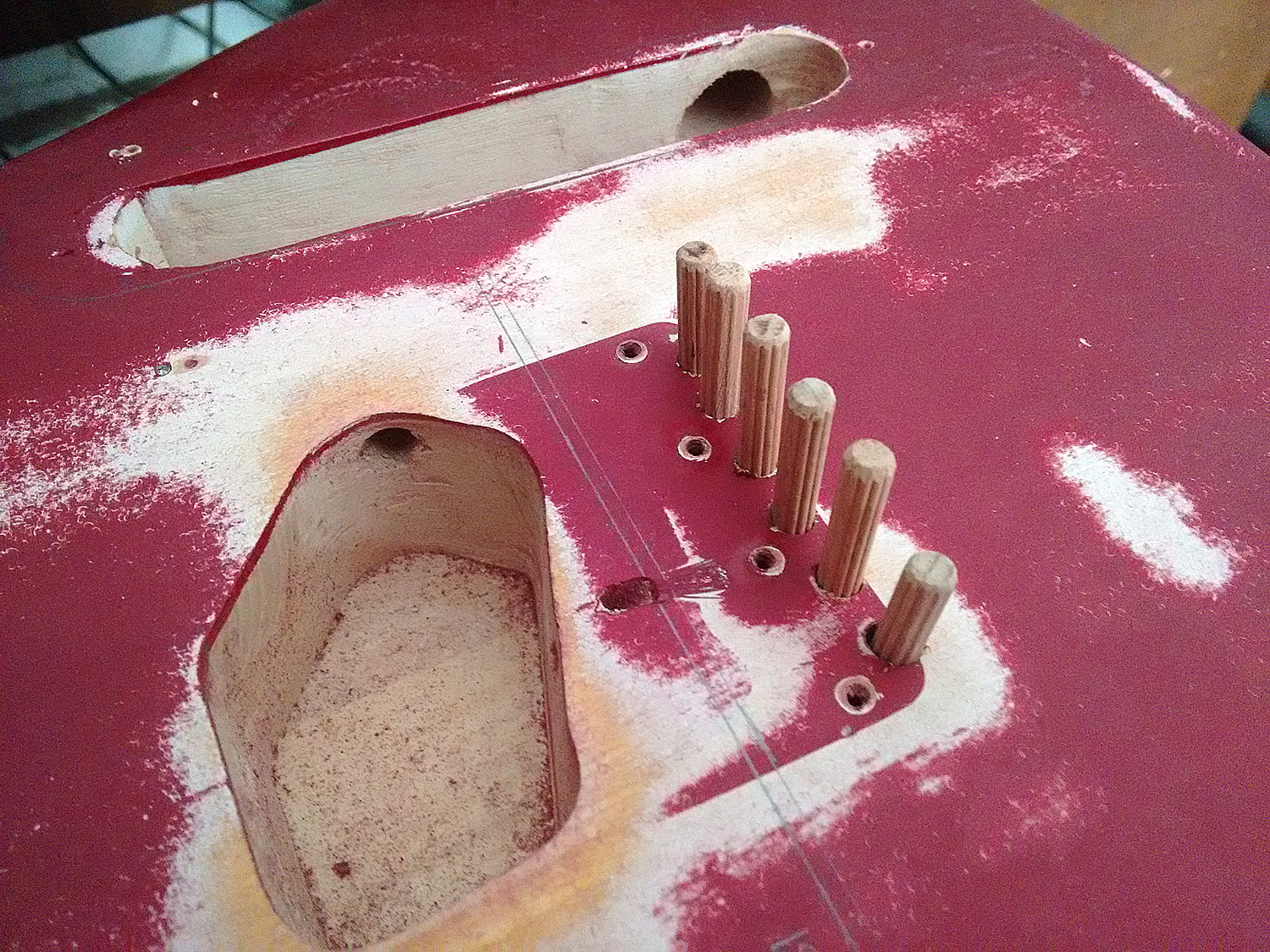

  6. #106
    Hardware removed and re-positioned in the 'correct' place.
    Looks like some routing and hole fillling is in the offing.
    cheers, Mark.

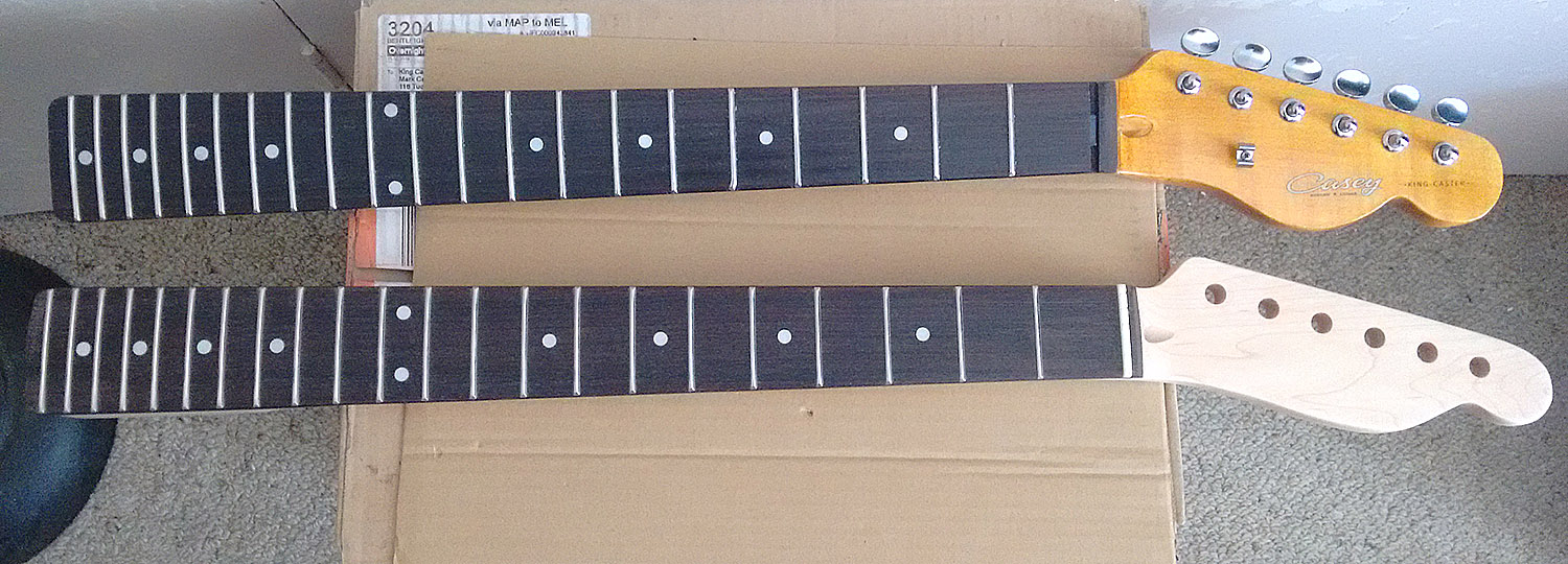

  8. #108
    ?? cheers, standby for a change.
    The Kmise neck 22 fret neck arrived.
    I'll probably add a few mm to the butt end to bring the scale length forward.
    Still contemplating possibly fitting a Trem-King to it.
    cheers, Mark.
  9. #109
    Ah nothing like a fresh packet of dowels.
    6mm this time.
    To plug the mis-placed string through holes.
    cheers, Mark.

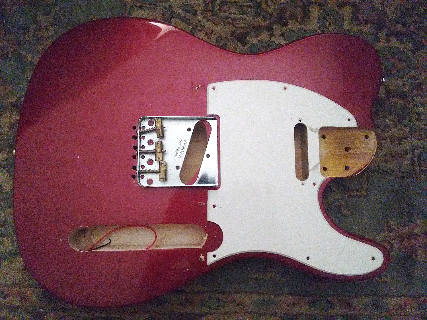

  10. #110
    Now have it in standard Telecaster scale.
    If I do go ahead and install a Trem-King it will mean gouging out all the dowelling work that I just completed.
    I still have some pickup cavity routing to complete.
    I think I'll stick with RED, however a standard candy apple version as opposed to the darker.
    cheers, Mark.
