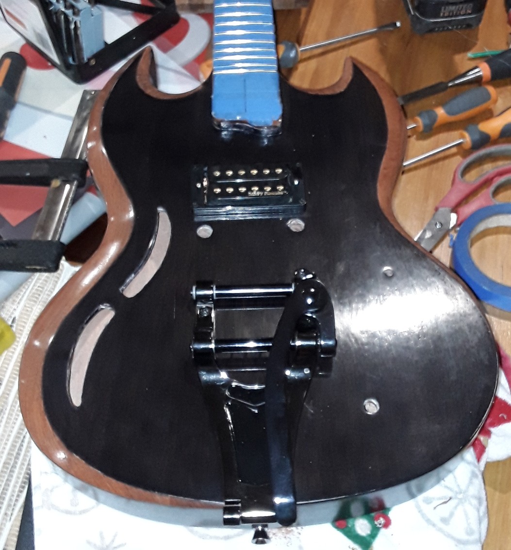

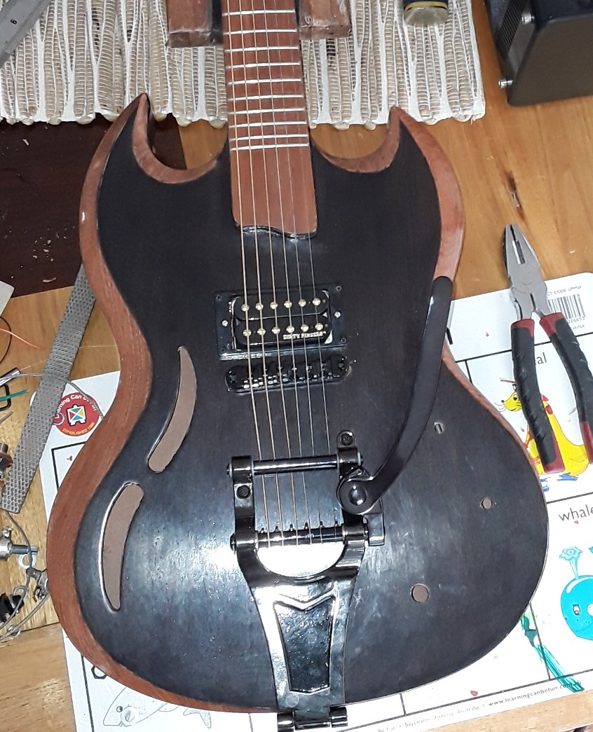

So had a go at using dingo wax on the fretboard then super glue on the fret seems tohave held the fret and allowed me to scrape the super glue of easily

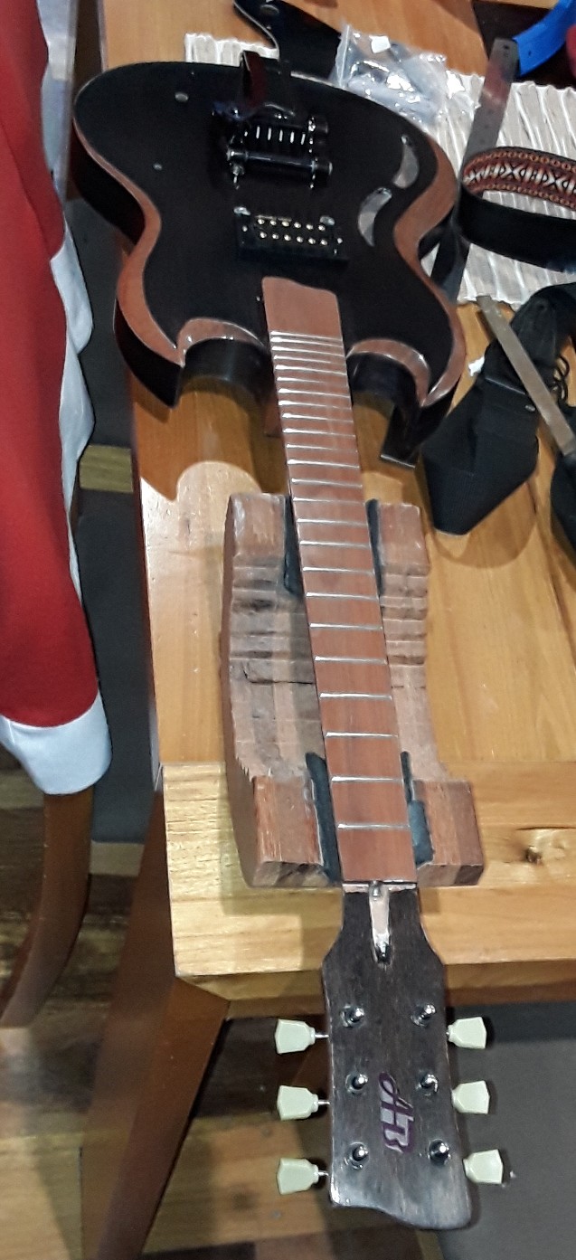

You always have an interesting style of dyeing guitars Barnsey. Its very unique![]()
Ahhh the wait.......actually postage has been pretty fast lately.
👍 This is a truly unique build.

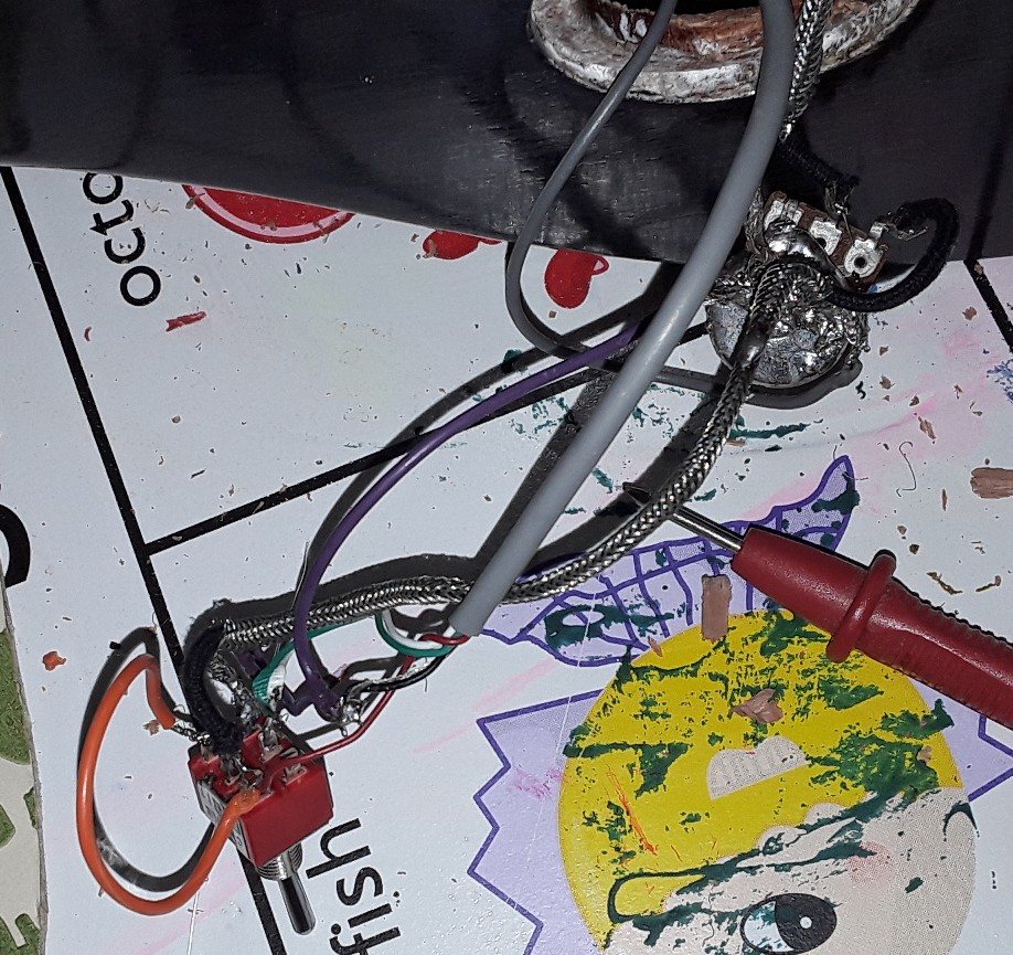

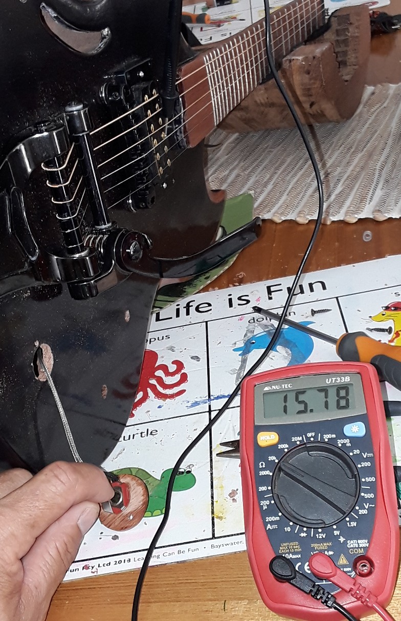

So I'm having dramas with the wiring. I had it all working outside of the guitar then when i tried to fit it the thread on the pot and jack plug weren't long enough. Sorted that out and redid the wiring and now ive got no sound, the current tester is reading 15 plus from all active points to an earth point so I'm a bit stumped as to whats wrongthe pic has te active on the jack tip and earth to one of the pickup slugs
