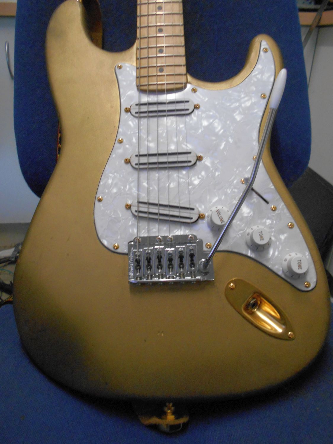

    I thought I would start this build diary in anticipation of my first ever PBG kit which I'll be ordering next Tuesday, I've chosen the PBG STA-1M kit for my first kit build, firstly because I used to own a 2010 Fender Mexican Strat that I traded for a Chibson Angus SG, so I thought it would be cool to build a replacement Strat rather than shell out another $999.00 to buy a new one, secondly it looks like an easy enough kit to build, the actual wiring will be fairly easy for me to do.
    Okay so here's what I've got planned for this build:
    * Upgrade the Chrome hardware to gold.
    * Upgrade the scratchplate to white pearloid.
    * Upgrade the stock pickups to a set of Entwistle XS62N's.
    * Upgrade the stock nut to a pre-shaped and cut Bone nut.
    * PBG sticker for the headstock, or get Andyport to make a custom decal.

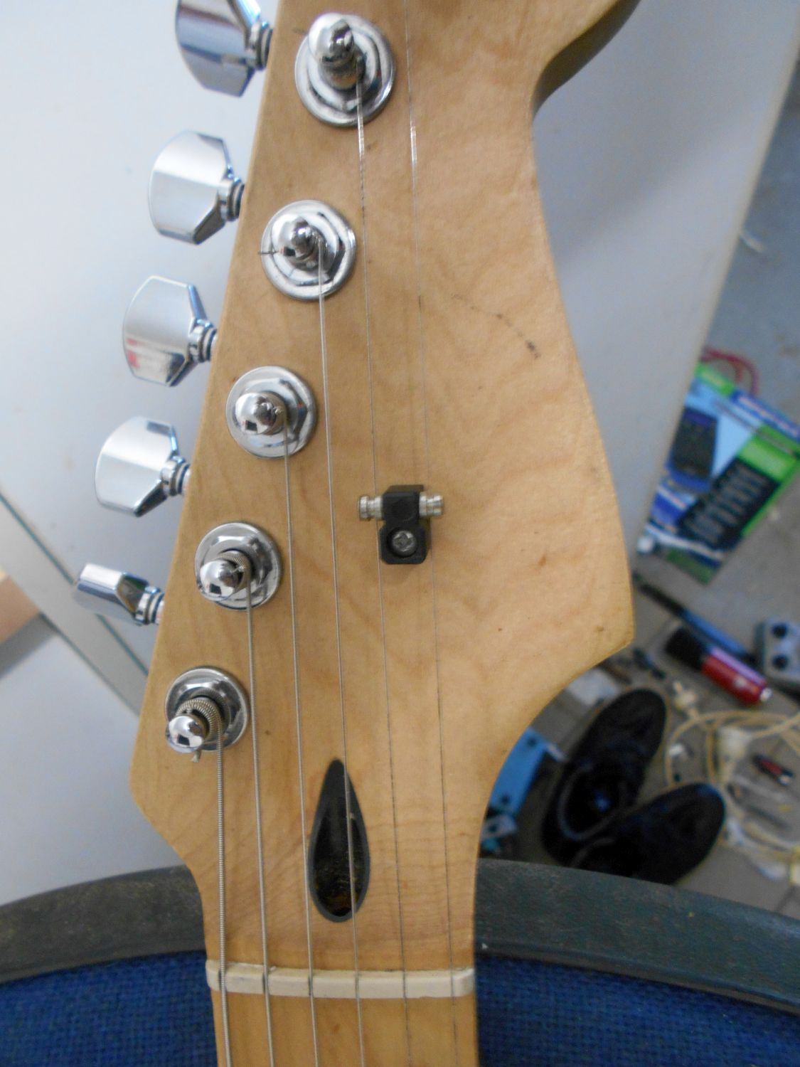

    * Upgrade the Gold tuners to a set of Gold 6-in-line Grover Mini locking Rotomatics.
    * At a later stage upgrade the Gold Bridge to a Gold Babicz Bridge.
    * Buy a set of Ernie Ball Strap locks for the guitar and install them.

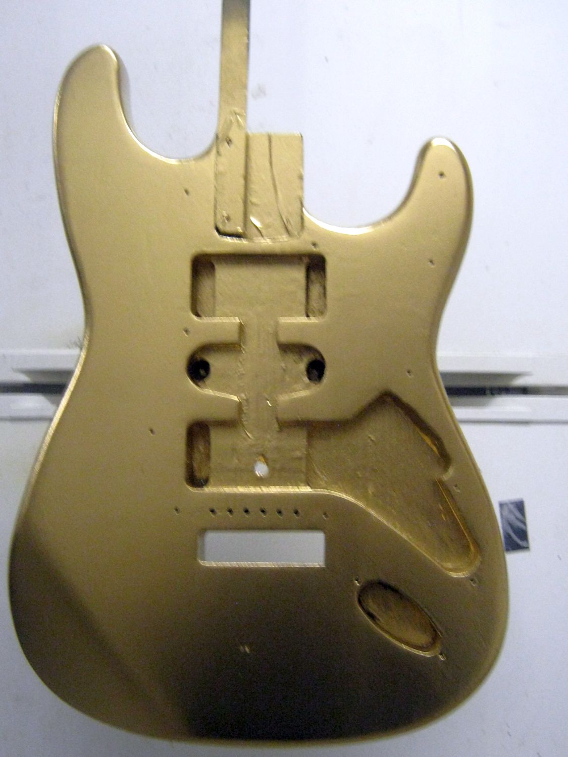

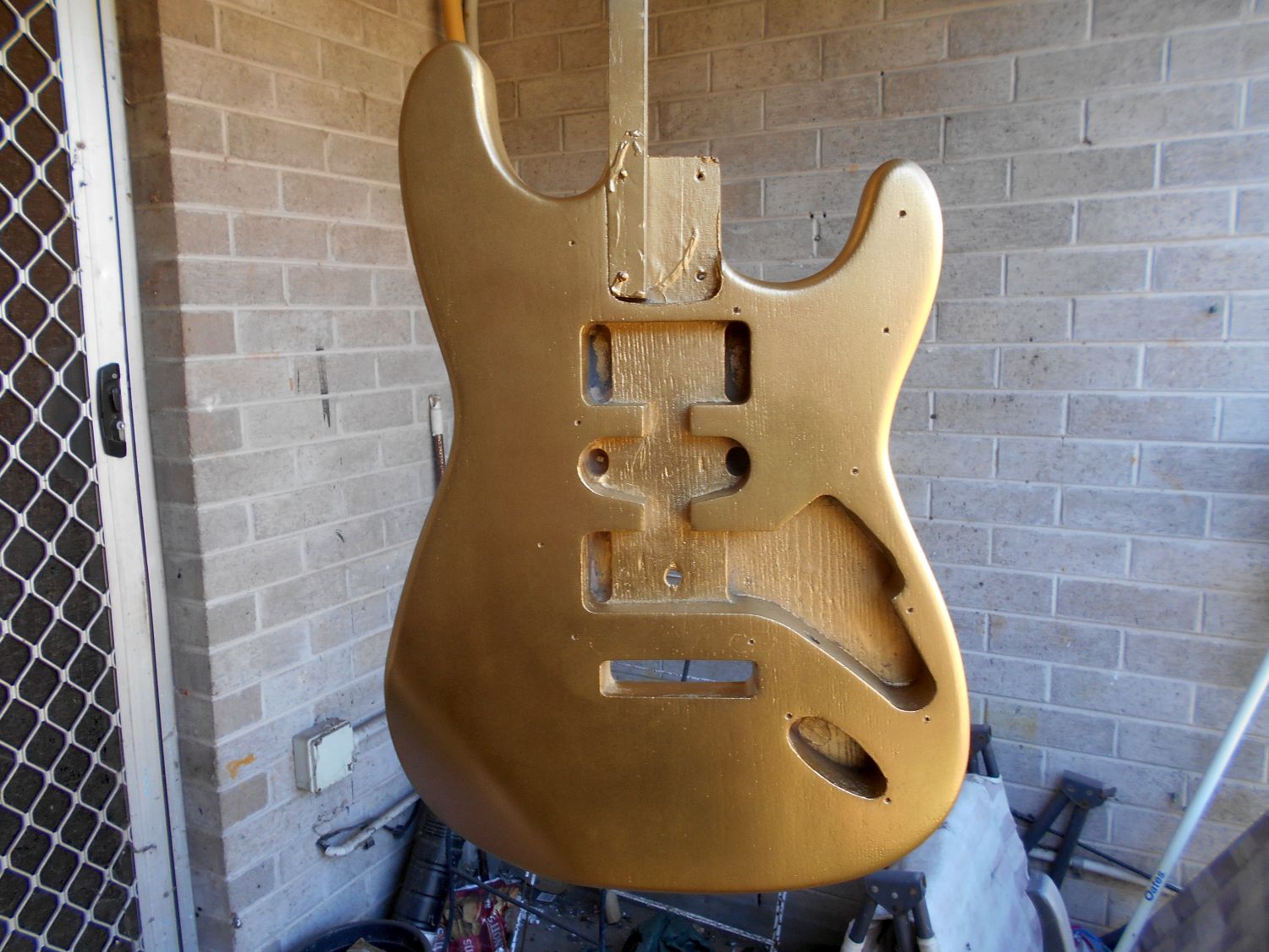

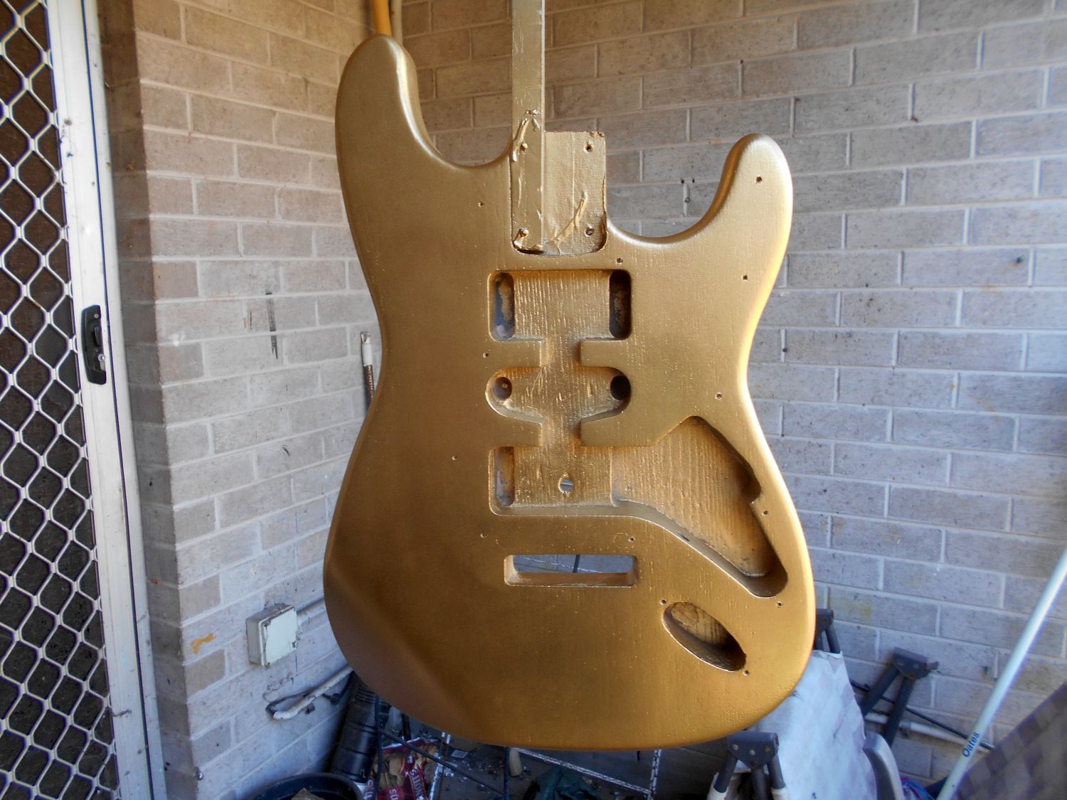

    I had initially planned on spray-painting the body metallic red, but after seeing one of wokka's gold finish builds I remembered seeing some cans of metallic-gold paint in my local green shed (Bunnings), yeah I know....automatic sentence to the naughty warehouse, it's okay I'll take my punishment like a man....lol.
    The cans of Gold paint I saw had tops on them with a really shiny gold colour with a metallic lusture, I was originally going to buy a can for one of my many pedal builds but thought that the colour would look cool on the guitar.
    The body will be clear-coated after the paint has fully dried.
    The neck is going to be clear-coated with the front of the headstock spray-painted metallic gold, I'm just wondering how I should finish the fretboard.
    I decided to call my STA-1M the Gold-Standard Strat, it's Gold Coloured, and a standard Stratocaster, hence the name.

    I almost forgot to add that I'll also be going with the traditional Strat headstock shape for this build, I happen to have a spare Mighty Mite Strat neck that i can use to make a template from.
