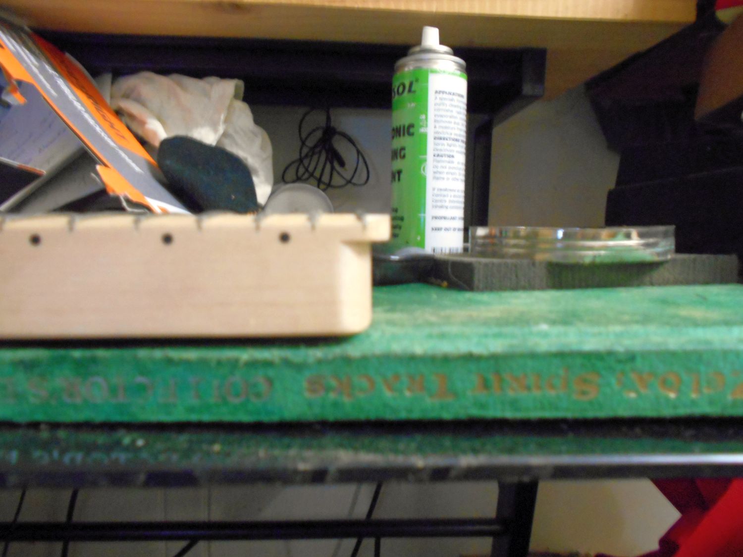

    Here's what the neck overhang looks like viewed from the side of the neck:
Name:	Neck Overhang_resized.jpg

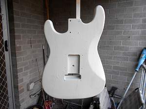

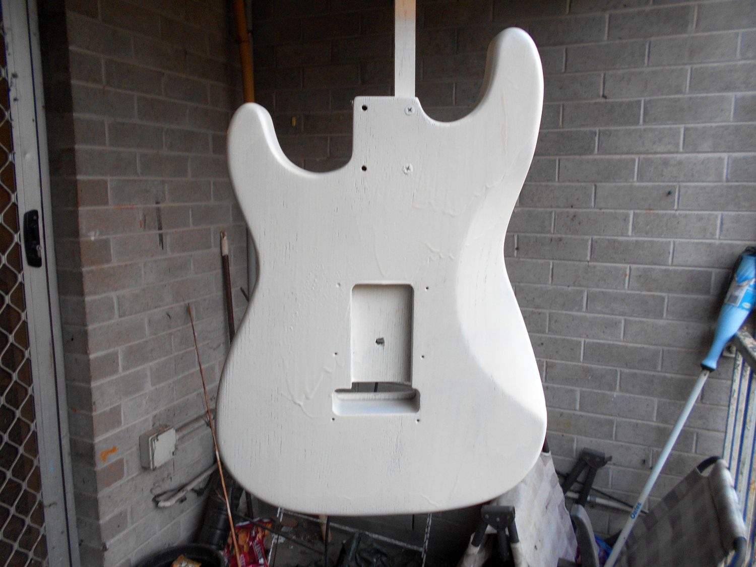

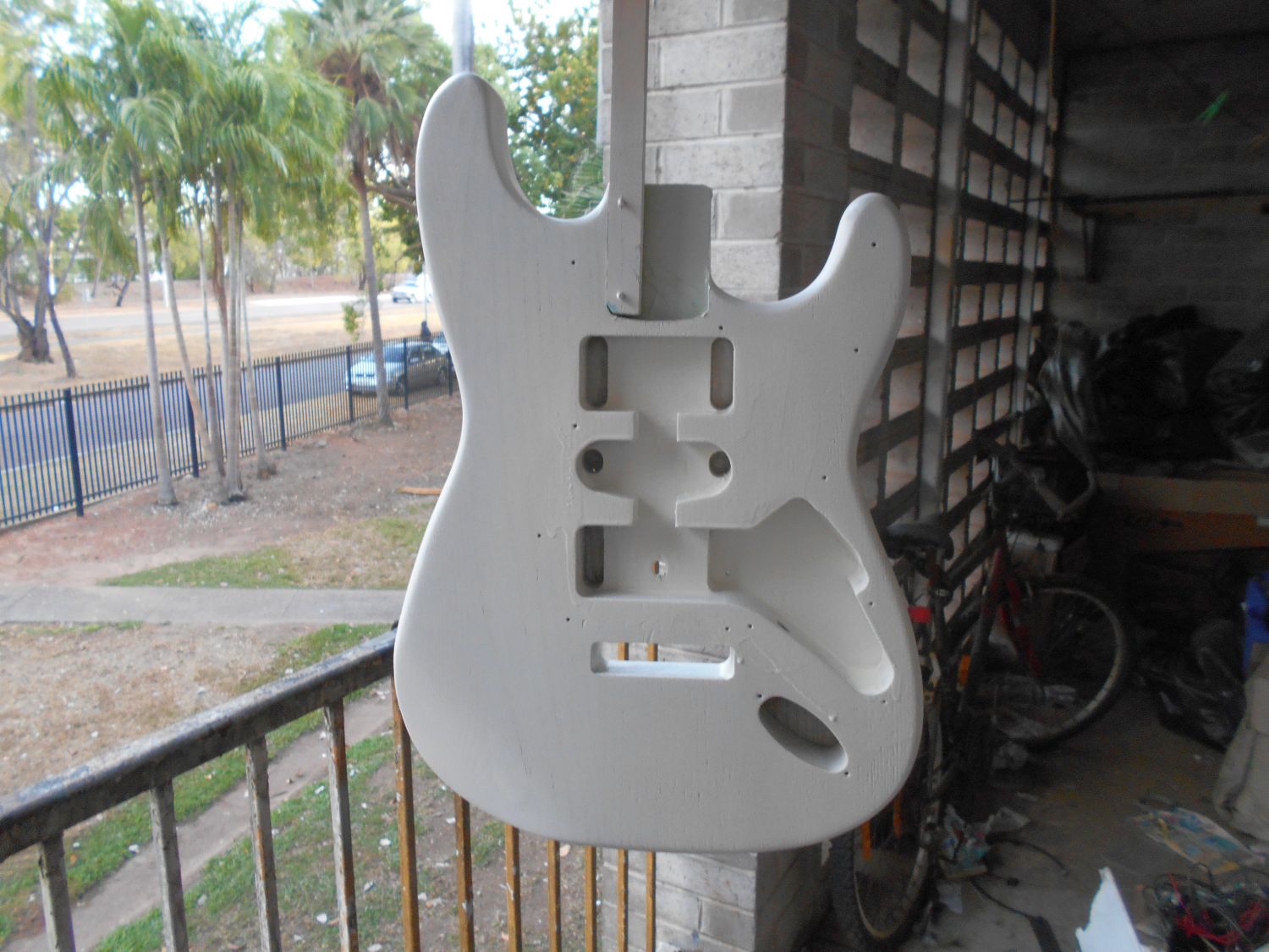

    Okay, here's a couple of pics of the Gold Strat body I took just after I finished spraying it with White Knight White Undercoat paint, I checked to see if there were any major issues but it looks fine apart from some paint runs, it was already touch-dry when I checked it a minute ago:
Name:	Undercoat 1_resized.jpg
Name:	Undercoat 2_resized.jpg
    I reckon all it'll probably need is a light sanding to even out the surface and then a second coat of Undercoat and then I'll be ready to spray the body with the Gold paint.

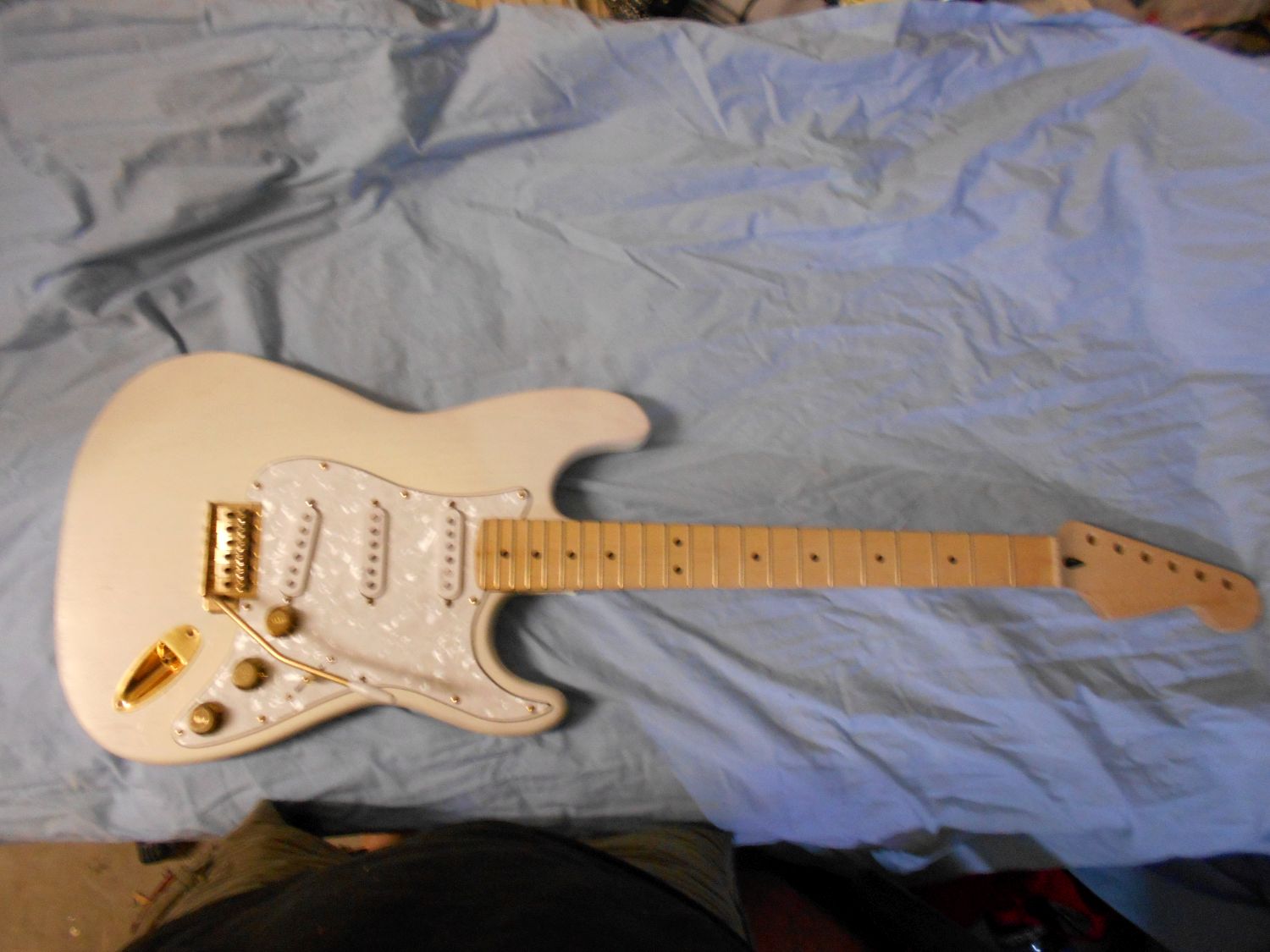

    Update:
    I managed to get the pickups, etc, re-installed in the Scratchplate, then I decided to put the Scratchplate on the Gold Strat body now that the White Undercoat had been drying for a few hours, I also put the Gold Jackplate and the original Gold Bridge (minus the screws) on the Scratchplate too, then I couldn't resist the urge to take a pic of the Gold Strat "as it was" for you guys, so here's what the Gold Strat could look like if I was to paint it White instead of Gold, does it look cool or what?:
Name:	White Strat_resized.jpg
    Maybe I could buy another STA-1M kit at a later date and paint it white, and put gold hardware on it?
