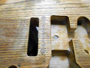

    I drilled out each of the mounting screw holes for the original bridge to 6mm so that I could fill them with some 6mm Oak Dowelling, I did this because the original holes had been drilled in the wrong place so that they were about 2mm further from the neck than where they should have been, I glued the pieces of 6mm Oak Dowelling in place with some PVA glue after using a small hammer to hammer them in, after that, I used a hacksaw blade to trim the 6mm Oak Dowelling flush with the top of the Strat Body, next I used a sharp Stanley-knife blade to shave-off excess wood from the 6mm Oak Dowelling so they were perfectly flush, and then a bit of sanding finished the job off.
    I think the Strat Body is almost ready to have it's first coat of primer applied, but I might apply some Maple Timbermate first though, just in case some grain needs to be filled.
Name:	6mm Holes Dowelled_resized.jpg
    It looks a bit unsightly, but I reckon it's not going to cause any major issues, since I'm re-finishing the body in a solid colour, besides, most of it is going to be covered up by the new SuperVee Bladerunner Bridge, so I'm not too worried about it at all.
