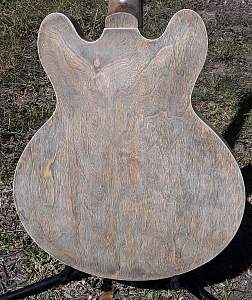

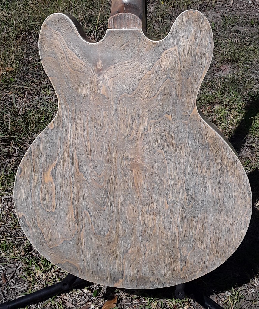

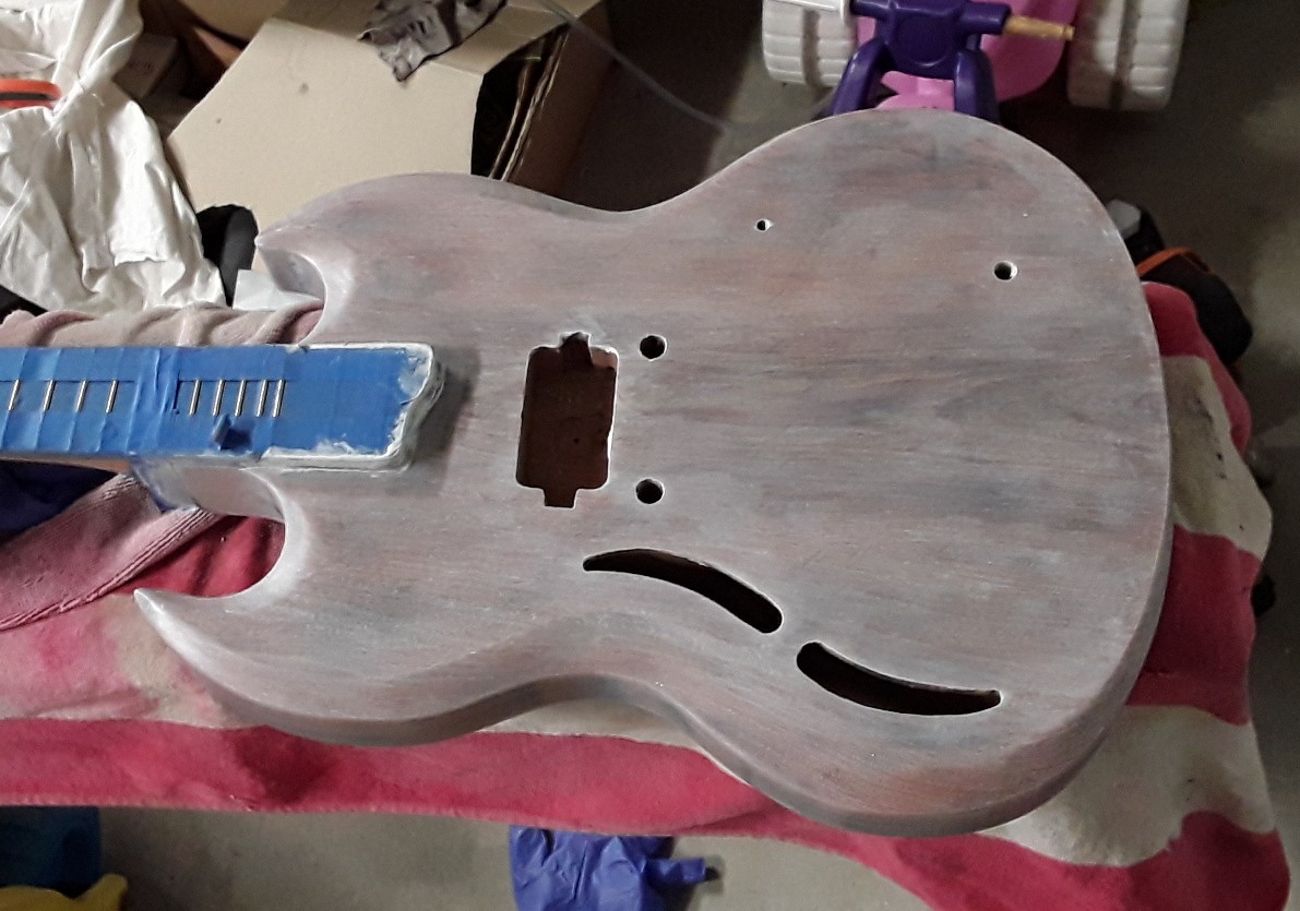

    Good call I tried something similar on a telecaster good in theory but the whitewash just didn’t take

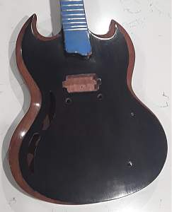

    Attachment 29115 back in black the white wash looked terrible
    sometimes you gotta go back to move forward. Loving this build btw.👍🏾

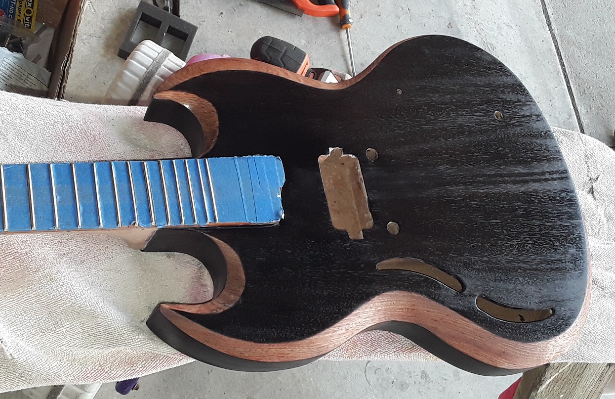

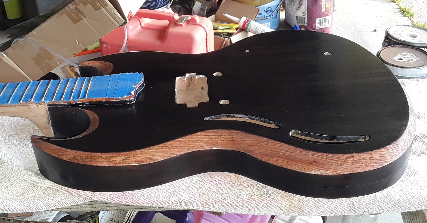

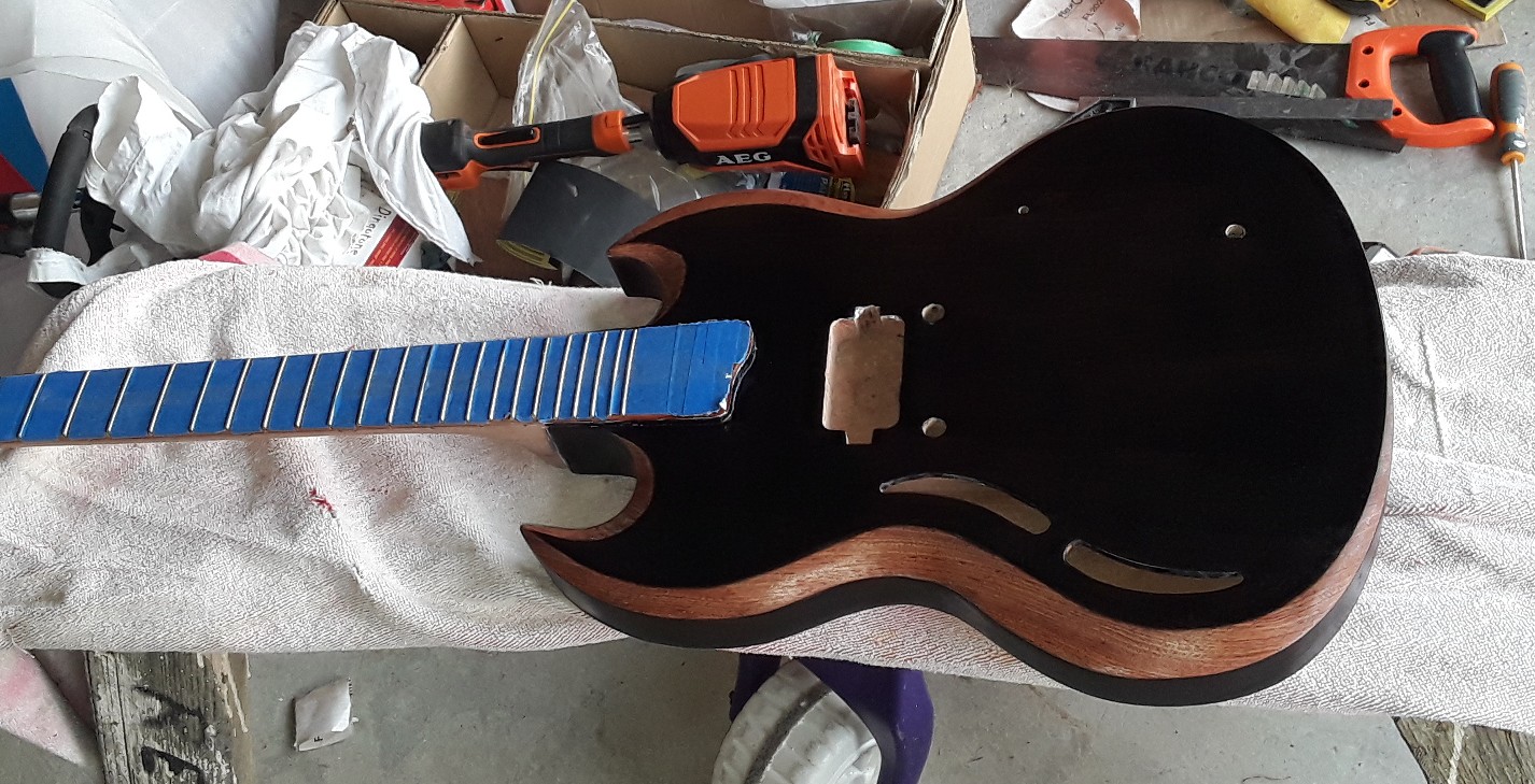

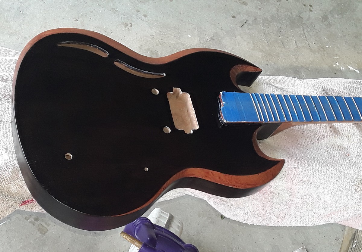

ID:	29137 I'm happy with the look now so first coat of tung oil this afternoon

    Thinking about it (with obvious hindsight), it might have been better to do the white first, then try and grain fill with black filler over the top. You may then have needed another white coat after sanding back. There are enough small pores in mahogany to show the grain pattern and make it look interesting (like a Gibson 'TV yellow' finish), but it hasn't got the cross-grain figuring that flame or quilted maple has to take up a darker colour for 'popping'.
    Thanks simon. After looking at my other builds i don't think mahogany is really suitable for grain popping Click image for larger version.
ID:	29157 same process on basewood Click image for larger version.
ID:	29158and the mahogany its all a learning curve

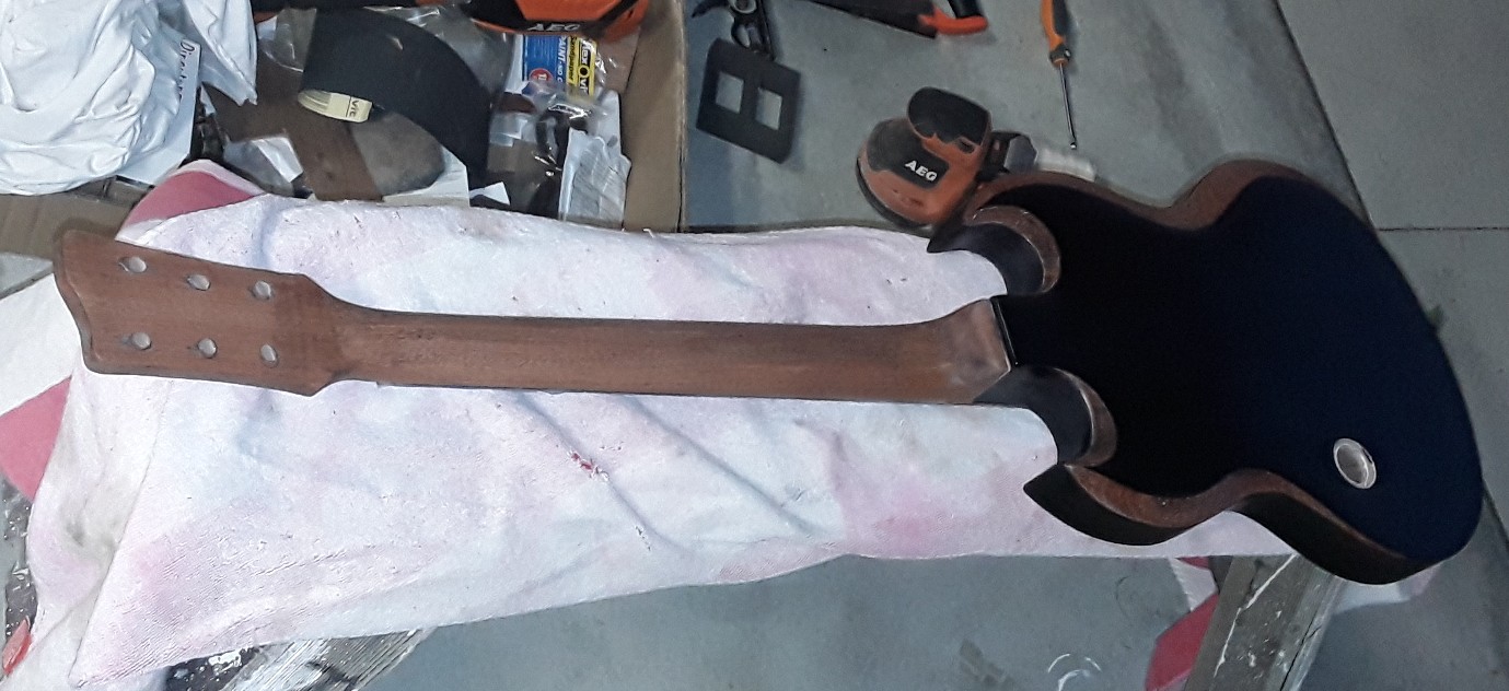

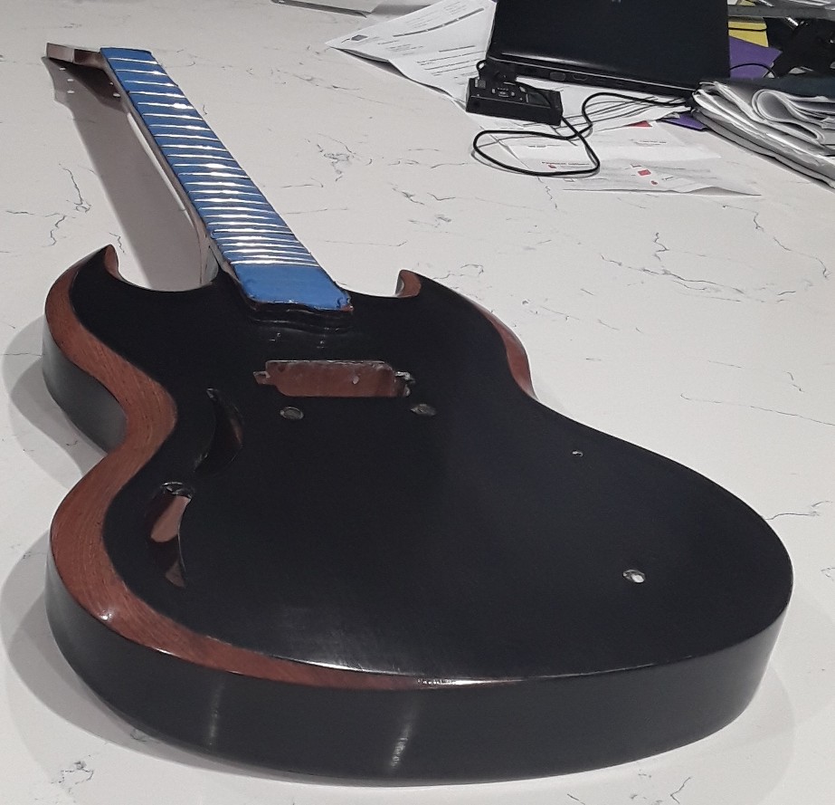

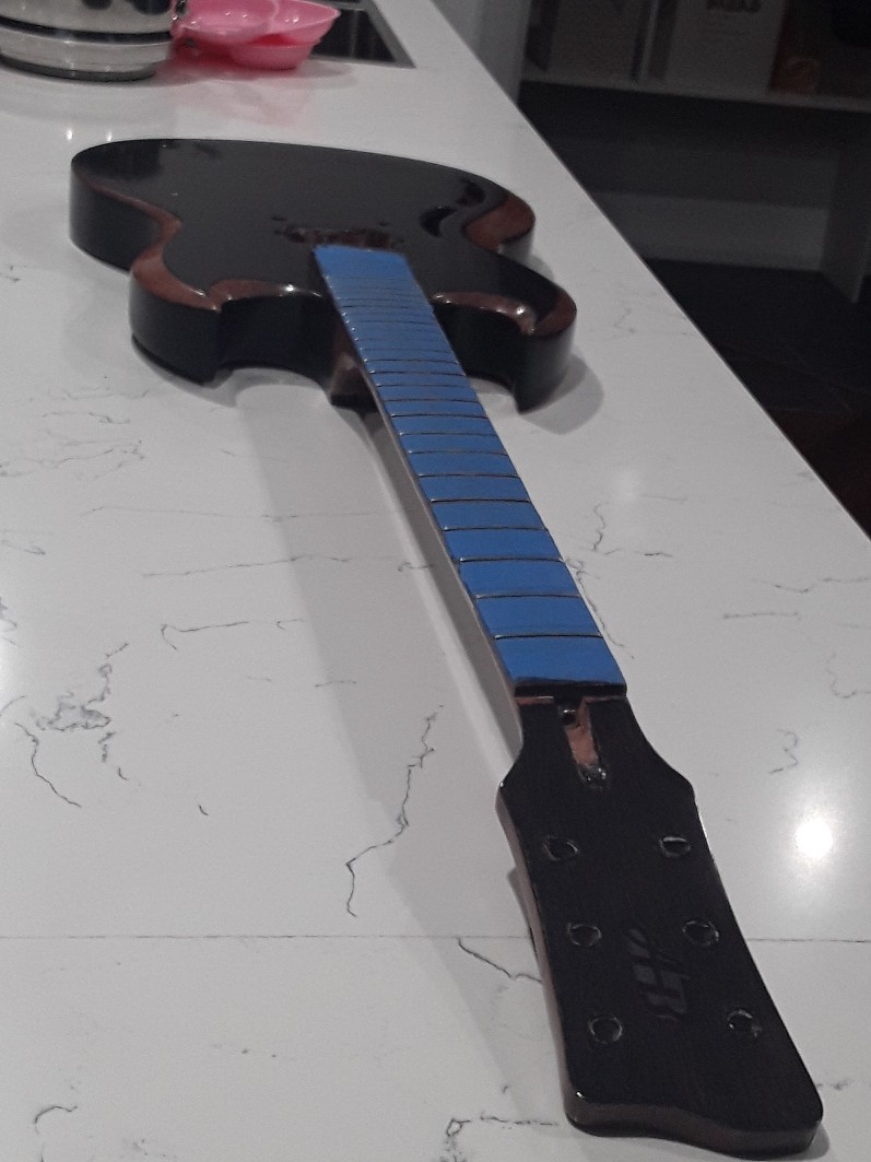

ID:	29292 all polished up and shiny, ready to start work on the frets but ive got 2 frets that have lifted and need to be glued back down. Anyone got any tips

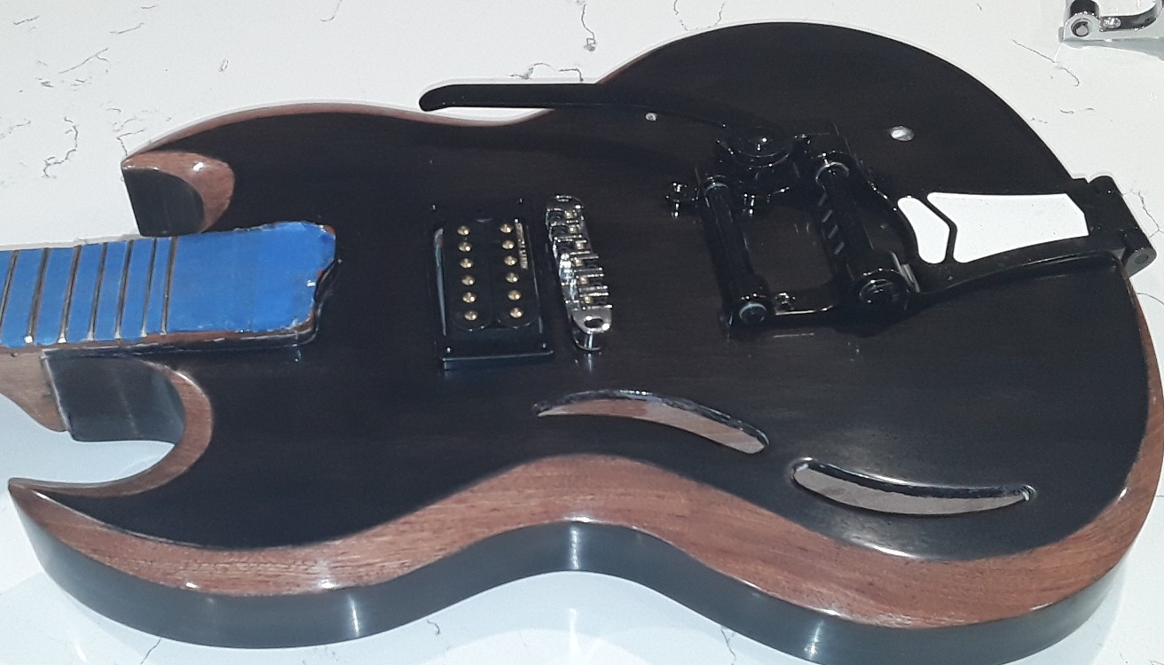

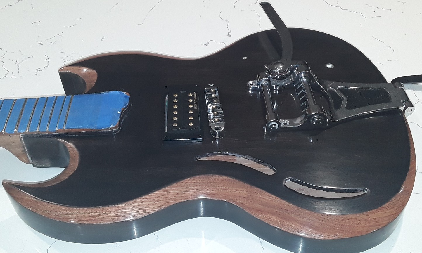

ID:	29297 now i need to decide between black or crome
    Check your slot depth and the roll radius you used, I typically roll them a bit tighter than the board radius whic seems to help the seat tight at the ends.
  10. #100
    Mentor Adam Barnes's Avatar
    Feb 2017
    norah head nsw
    613
    There actually loose i can push the up and down, ive seen a few you tube vids were tthe use super glue to re seat the fret, looking at the photo theres actually 4 sitting high
