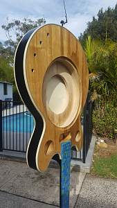

    This paint and poly caper takes a long time ;-)
    Two more days of poly, two weeks to cure then a day sanding and polishing.
    Glad I don't have a gig this weekend with it :-)

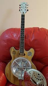

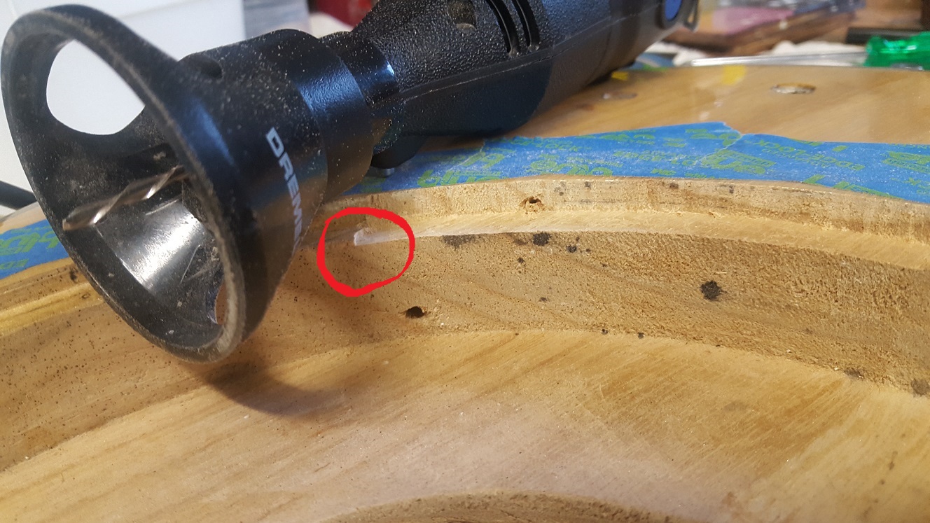

    The finish is now hard and a couple of days away from the final sand and polish. Today I took opportunity to correctly slot the nut and make a bridge.
    BUMMER, I couldn't get the action low enough so after a bit of a think decided to mill timber off the surface the cone sits on and in turn drop the bridge.
    This shows a witness mark of old cone level.

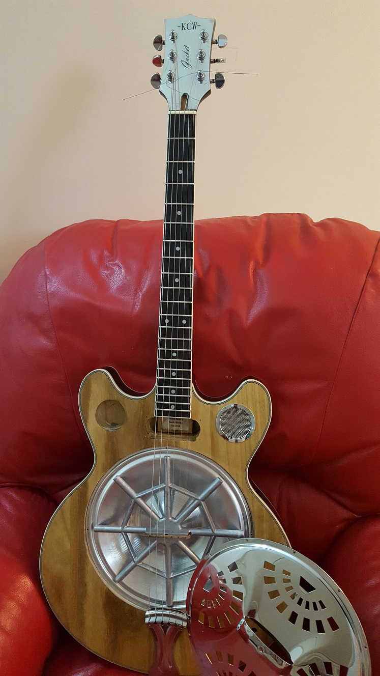

    Almost done, hope to finish it this coming week.

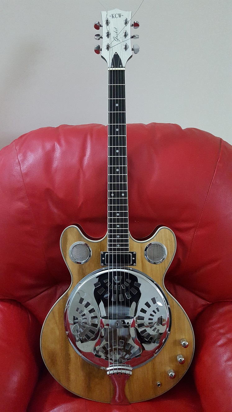

    348
    The "halo effect" polished out, happy days!
    Late today I was happy with the finish so decided to assemble.
    Very happy with the look, feel and tone, a couple of small tweaks tomorrow and it's over :-)
