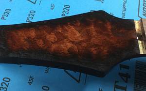

    Well the quality of the quilted maple headstock veneer (from the sam supplier) was of substantially better quality.
    I'm finally ready to start applying the finish coats on the neck. Already started on the body.
    One thing bothering me. The fretboard feels quite rough. I haven't seen any builds where the fretboard needed sanding. Maybe I'm not looking at enough build threads.
    How does one go about sanding the fretboard with the frets installed?
