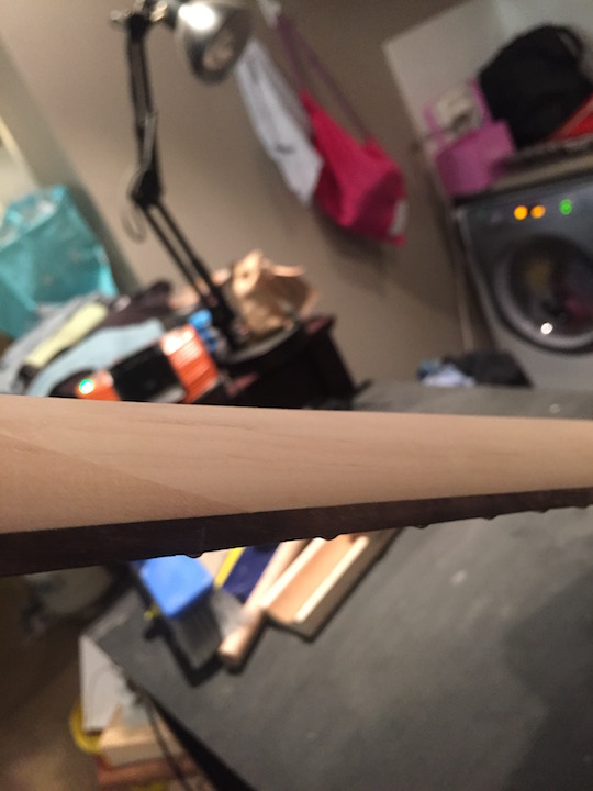

    Okay so we have been a bit quiet on the completing of build front, as I have been doing actual work and experimenting with Timber mate application.
    Major build event this weekend has occurred, the reuniting of Fretboard and neck!
ID:	8810 Click image for larger version.
    SO you can see from the below that the neck joint hasn't turned out quite as tidy as I'd planned but it is nothing calling for ashes and sackcloth so we shall just push on with it.
ID:	8812 Click image for larger version.

    Neck also got some reshaping done, in order to thin it down some more, nice and silky now!
ID:	8925 Click image for larger version.
    Happily a small opening up of the neck splice got filled and closed by the reuniting of FB and neck, so no longer need to worry about that.
