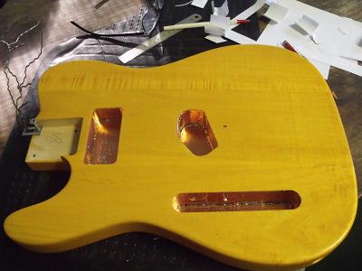

    I'm up to the second coat of intensifier on the body next and am liking the colour.
    The neck has had one coat of finish (4 days ago) but I don't like the feel of it yet... a bit 'clingy'... I'm hoping that improves as it cures.
    I've finished the copper shielding... a bit of a pox to get right... and have soldered all joins. A bit over the top but done anyway :-)
    Do I need to shield the holes the wires go through???

  7. #27
    Nice colour happening there Rob.

    Moderator dingobass's Avatar
    4,491
    Thats coming up nicely.
    No need to shield the wire holes.
    The neck coats will settle in, it seems to take a bit longer on Rock Maple.
    I think this may be due to it not being overly absorbent so it takes a bit longer for the cross linking polymerisation to happen.
    Big word of the day, polymerisation
  9. #29
    Thanks Dingobass... I'll try to be more patient with the neck.
    Loving the big word of the day but I reckon I might struggle to drop it into most conversations
  10. #30
    Thanks Wazkelly... I reckon a couple more coats of intensifier and she'll be ready for finishing.
    There's a 'dry' looking patch on the back where the timber has absorbed the colour differently... I was a bit worried about it at first but figure not all timber will behave the same so I'll let nature have its way.
