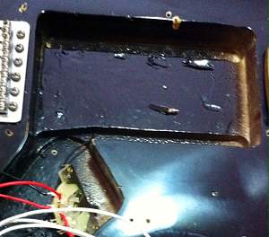

    The donor guitar in this instance is a late 90's Korean made Magnum Strat Copy that originally looked like an Eric Clapton version with white scratch plate and maple fret board. First mods were to replace machine heads with Schallers as one of the stock units fell apart whilst tuning and they never stayed in tune anyway. Gave the neck a once over by lowering the action and proper intonation and was quite impressed with this bit of timber bolted onto a rather dull sounding body. Reason for the dull sound was more to do with a massive rectangular cavity routed for pickups and the PUP's just floating from the pick guard. Functional for a primary school student to learn on.
Name:	photo back of body.jpg
ID:	8421Click image for larger version.
