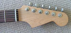

Neck and Finished
Warmoth Vintage C shape replacement neck, headstock with Sperzel Lockers. Neck is Maple with rosewood finger board 1-5/8 at the nut Straight 7.25" Radius, Cream Face Dots frets are Vintage Jumbo. I found this neck on the Warmoth showcase.Neck is finished in Nitro clear Matt finish.
Tuners: Sperzel lockers.
