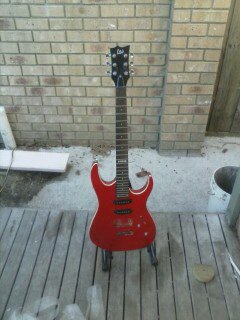

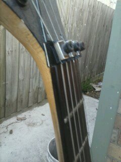

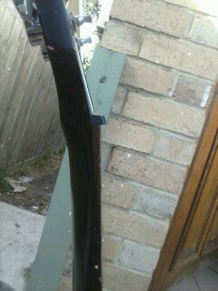

    Hey guys, so already I've read so much helpful stuff here on this that and everything in-between, and I was looking for some advice. I've got a guitar that I'm bits'n'piecing and I've nicked the neck off an LTD EC-50. However the body has a route (just for strat styled trem at the moment) that I want to adjust into a Floyd Rose fitting, and as such, need to do something about the nut, to put Locking Nuts there. Has anyone got any suggestions, advice, or tips about this?

    Might need a new neck or just graft on some scrap wood and file away the upper part of the board?
    Yeah, I've seen something similar done to a Charvette I own. What do you mean "part of the board"?
    Zac you better find out the dimensions of the floyd rose bridge and I'd tape off the dimension on the body to see if it will work. You will need the 2 pivot screws and there is quite a large route for the FR body.
    Should be able to get a lock nut conversion set I'd say but that will need a fair bit of work too
    The Tonerider and Entwistle pickups on the Pitbull site are pretty good value check them out
    Cheers, I'll do that whenever I get the chance. I believe (though not a very accurate method) I placed a spare Floyd Rose I used to have in the route to see if it roughly might fit, and it sat in the correct placement (posts excluded) and the string blocks lined up pretty well with the pole pieces of the pickups. I will tape it all though just to re-affirm this. I've got not issue with the recessing, as I have done it before for a friend, and am fairly confident in doing that.

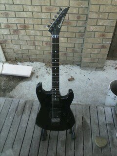

    This is the Charvette with the seemingly converted nut.

    The FR needs a recess the length of the tremelo to where the fine adjustment screws are.
