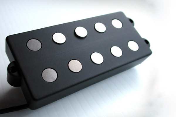

    if you found a suitable surround couldn't you screw/nut and mount them in the surround DB ? I've never seen it done. Would be hard to find a surround with the 2 holes on the right side.
    Or can you glue a block inside to mount it ?

    Moderator dingobass's Avatar
    4,491
    The biggest issue to try and work around would be height adjustment.
    Pups with ears are designed in a way that allows for this but pups with lugs are designed to be direct mounts..
