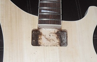

Photo of neck set, extra glue into the wells either side of the neck for my home made hardwood filler, saw dust from a hardwood this happens to be walnut, mixed with Titebond into a paste and built up allowing each layer to dry, this should give the neck more stability.
