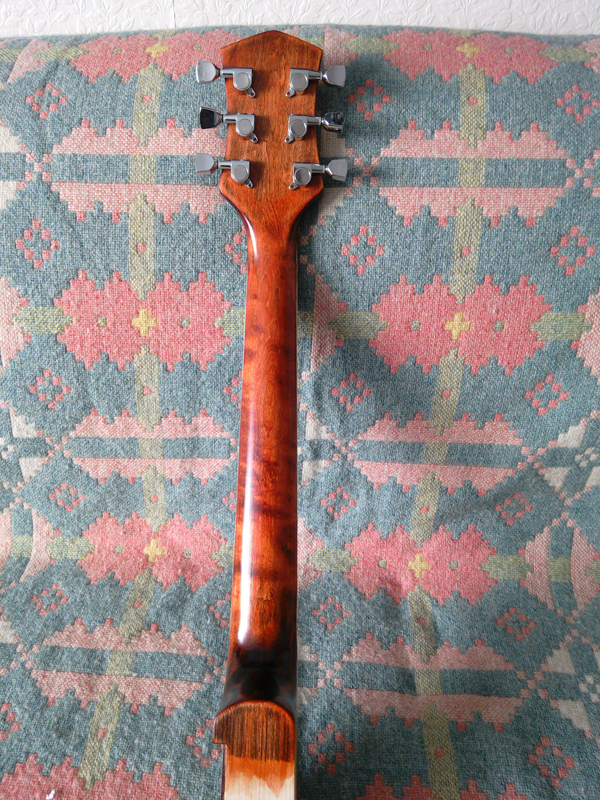

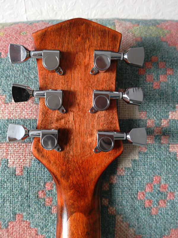

Name:	Headstock rear1.jpg
ID:	8788Fitted the machine heads and although I pre drilled the screw holes found the screws to be quite long, so had to be very careful not to drill too deep. As a result the first screw head snapped off. So now have to drill the screw out of the hole and try again. still its starting to take shape.
    Moderator dingobass's Avatar
    4,491
    Bummer about the screw.. Is there any of the shaft poking out? If there is you can try grabbing it with pliers.
    Another trick is to see if you can file a slot in it and use a flat bladed screw driver.
    Another handy tip is to smear a little bit of soap on the screw thread before driving it, that should help stop shearing the head off the pesky little buggers.
    Member Chazking's Avatar
    Nottingham, England
    30
    Drilled the screw out. I measured the depth of the screw and depth of the headstock. Both are 12mm. So I'll be getting slightly shorter screws. I take your point about a bit of soap good idea
