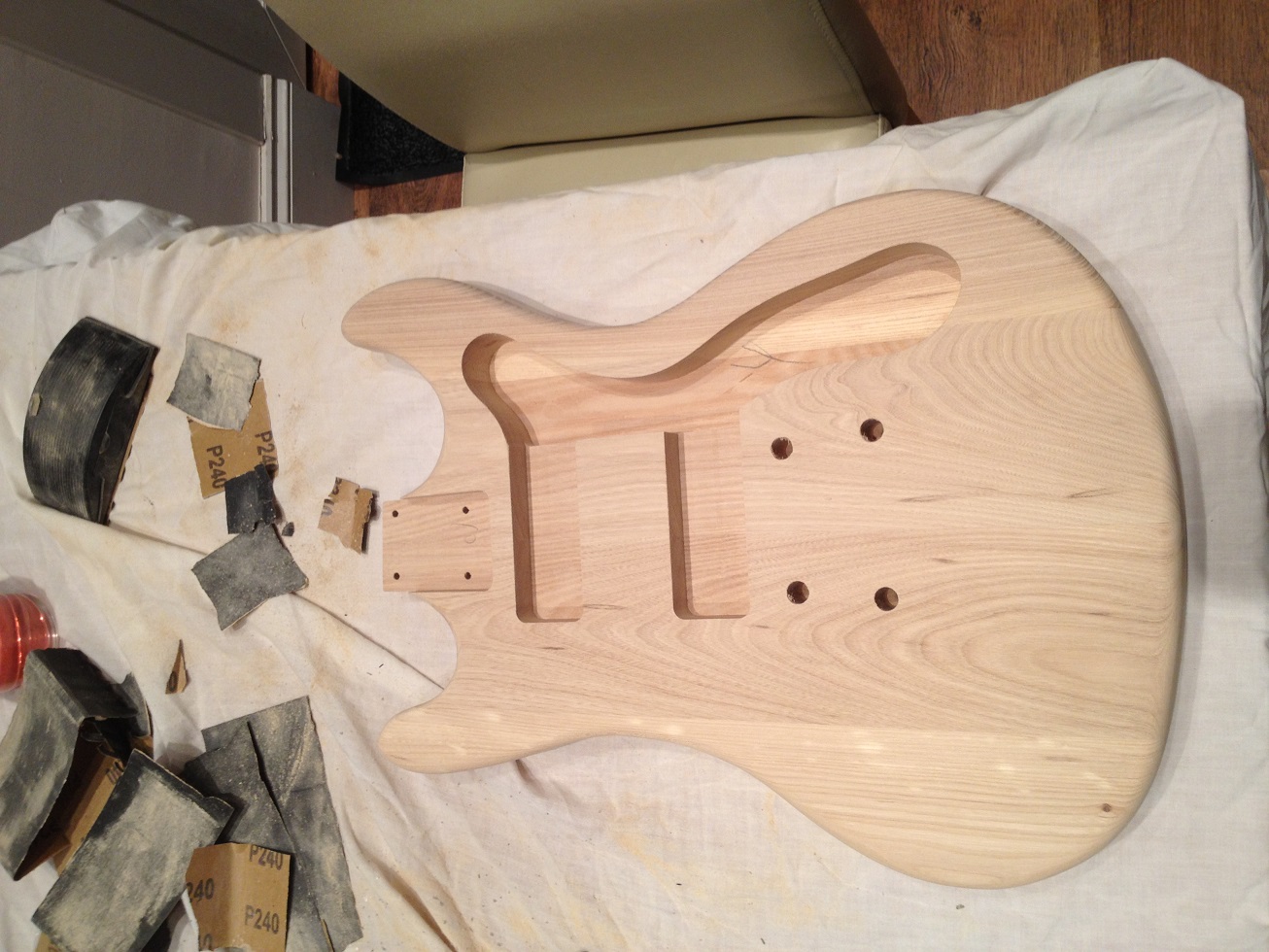

    Last night we commenced sanding!
    Spent about 2 hours on the 240 grit, Nat had a couple of machine marks on her butt to get rid of
    Now she has a lovely smooth bottom
    The 600 grit only took about 20 mins, gonna finish up with the 1200 grit tonight.

    There is absolutely no difference in the pictures, but here they are sanded... (Imagine tree bark when looking at the above ones, and silk when looking at these!)
    Mine: Click image for larger version.
    Nat's: Click image for larger version.
    Moderator dingobass's Avatar
    4,491
    Love it when folk get into the sanding
    Only thing I can say is you are best not go past 400 grit, finishes need a fair amount of tooth to hang onto.
    Sanding to 1200 polishes the timber to the extent where your finish has nothing to hang onto.
    Hi Mos-wrong, both kits look excellent. It's a shame you are going to cover that ash grain with white lacquer !
    The azure lagoon wudtone won't get really dark. You will need to get some darker dyes if you want a real deep blue. It will still look a bit darker on the ash grain though.
    Good luck to both of your builds
    I was just going by the Pitbull sanding video!
    Cheers for the feedback

    I think that video is for rattlecan finishes. I'm pretty sure on the Dingotone video DB says to stop at 320 or 400 or something like that.
    Well is it possible to sand back to 400 or hope that 600 is ok?
