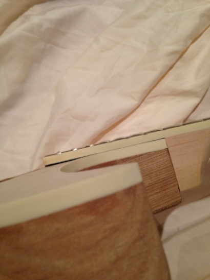

    Rest of it seemed to fit really well. The neck was a pretty tight fit, I've put a few pictures in, I'm assuming it's fitting correctly? There's a tiny gap at the bottom that's no real issue I don't think.
