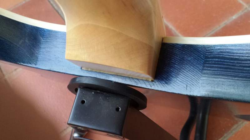

    I checked out Pablo and Lunaticthighs builds, looks pretty nice. The bending of the bottom of the neck pocket under load spooked me a little. Is two RC-4 builds the total so far? I'm curious if anyone else has had similar problems with the neck pocket.
    I've had no problems regarding the neck pocket, but after seeing LT's I was extra thorough and almost ready for it. 3 or so months of being strung up and no bellying or warping.

    Pablo,
    I know the fingerboard above body height is critical to playability, referenced to a specific bridge height. Using a stock Rickenbacker bridge would seem to require a fingerboard height just shy of 1/2" above body at the center of the fingerboard. I assume you didn't have to do any shimming or neck angle with the stock bridge provided with the kit? I'm also wondering if a set of dowels drilled into the heel end of the neck beam and into body below the neck pickup would stiffen up the whole assembly. Stock Rick basses have a huge "bathtub" of wood routed out for the neck pickup that weaken the neck through joint considerably.
    Hi Alex, I used a Kahler bridge so I had to shim the neck. I would assume using the stock bridge would not need it, but a ric bridge would to account for the height.
    As these kits aren't a true replica, I wouldn't assume any measurements. Just a matter of getting all the bits you are going to use and testing it out until you get it to fit right. Don't glue until you are sure.
