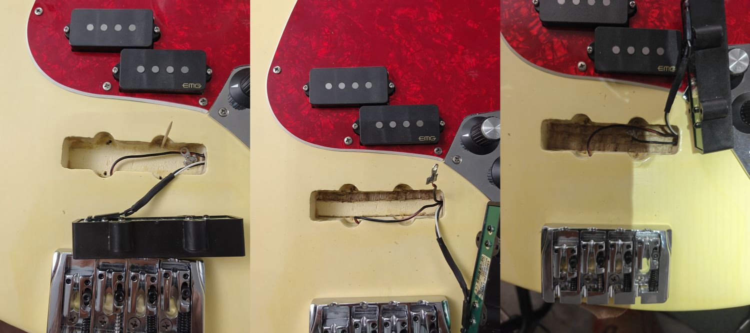

    I was planning to do a TRAIN setup...and should have known there'd be trouble when I got stuck after "Tune."
    There was no real difficulty in adjusting the truss rod (Relief), in the process I discovered that I could not get the bridge pickup to go low enough. So, I pulled off the strings and used a couple of chisels to drop the floor of the pickup cavity a few mm.
    That worked well enough, so I put the strings back on and tuned it up...got stuck on the next step as well (Action). It seems that the saddles are at their lowest point, but the action is way too high. I am going to need to shim. I haven't actually had to do this before. Any suggestions about the best way to shim?
  9. #88
    2,025
    You can purchase wooden shims from lots of places online.
    Or you could make up your own from wood veneer, card or hard plastic. If you make wooden shims you can sand then to a taper or wedge which uses up the length of the pocket.
    I tend to use layers of thin hard plastic and organize it into steps that get taller as you go down the neck pocket. The greater the number of layers needed the smaller the top of each step.
  10. #89
    3,084
    Years ago I made a tapered shim from some veneer, but I haven't a clue where I put it. I made it pretty much the way you make your plastic shims. I ended up going with a different bridge configuration and didn't end up needing the shim. Wish I could find it now! Easy enough to make, but the online shims seem cheaper the more I contemplate gluing and sanding veneer shims...
    I went on Amazon and found some wood shims from "Muspor" that *say* they are tapered with a 0.25, 0.5 and 1 degree tapers. Given that the body is pretty soft, I think I want to avoid a stepped shim. If anyone else buys them online it's probably a important to note that all the ones I found that were under $10 for a set of 3 were panned in the comments. Most said they often came with no taper at all. The Muspors were the cheapest I found with good reviews. The Stew Mac's have good reviews too and start around $35. $10 to have them here tomorrow ready to go seemed worth it. I seem to play this game a lot. $5 seems like too much of a risk that it won't be good. $10 for a no-name brand seems worth the risk...and I may be able to modify it--or just send it back if it's not good. Stew Mac seems like the sure thing and is what I would buy if it was someone else's money. Crossing fingers.
    Capo'ing the first fret the string clearance should be around 2.5mm. It's at 4.6mm. I looked at a trig calculator, and I figure it will need a half degree or a bit more to move it 3-4 mm at the bridge.
    Ironically I may not have needed to lower the rout on the bridge pickup, once the neck angle is properly aligned. Note to self: Do pickup height adjustments after doing setup.
