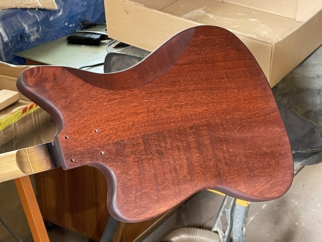

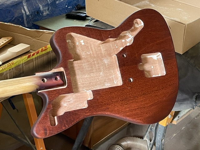

I have some p-90s ready to go. I'm not quite sure how I intend to connect the rhythm/lead switch yet.![]()
I prepared a slurry of cedar coloured Timbermate wood filler and hand rubbed it onto the body. Hopefully this will raise and fill the grain.
Sanded the body's wood filler back with 240 g.
Then added some Ubeaut sanding sealer to the neck and body, and when dry, denibbed with 600 g paper.
Then coated the body with 2 coats of Feast Watson Jarrah stain.
