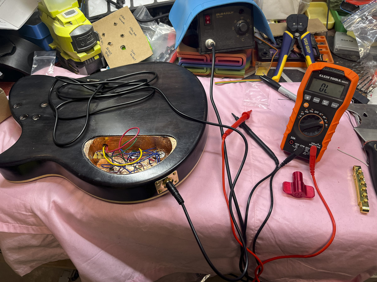

    bit more progress on lining components up, getting the wiring bird's nest sorted out and finalising alignment within the control cavity. Took a couple of goes and time with the multimeter to see where'd introduced a short...but finally got there with a positive 'tap-tap' when plugged into an amp and giving the humbuckers a gentle tap. I was worried enough there for a while to make the investment in Hayes 'Complete Guitar Wiring' to help me along. That said, now i've got an interesting book and resource to use in future builds.

    Great that the wiring is working for you with the "tap test".
    My 2 cents worth - As far as the circuit goes, you may have mixed up the volume pots with the tone pots! The tone pots should have the capacitor. Did you make the vol pots the A-type and tone pots the B-type? The circuit will still work if they are switched, but it will affect the amount of change as the volume and tone knobs are rotated.
    I would trim the length of the capacitor leg which hang off the bridge Tone pot.
    I would also add some insulation tape around the legs of the capacitors so that they cannot "short" against the other tabs of the tone pot. Likewise for the Treble bleed mod legs on the Neck volume pot.

    Keen eye for detail! when i made the template reversed the labels accidentally and ended up doing it backwards according to my cardboard, but the same as the pitbull wiring diagram. Also 100% correct on the cap legs, they caused me some grief and ended up being a short - but only when mounted in the cavity...that was a fun problem to solve.
    good suggestion on the insulation tape too, I dont have any floating around at the moment but will need to stop by bunnings for a few bits and pieces.

    ...I would trim the length of the capacitor leg which hang off the bridge Tone pot.
    +1 Good suggestions. If they have a little shrink wrap that would be good too ;-)
    You'll get less of a "birdsnest" by keeping the wires shorter. That's the advantage of using a template, as you have. You can see how long you need the wires to be...and it's generally shorter than you think when you are just eyeballing it (at least that's how it is for me!).
    I think at some stage in future I may rewire the lot with nicer pots and switches - in which case it'll definitely come up nicer with the shorter cables. Oddly enough, I didn't even consider the specific wire length when setting the template up...just that it was for everything being wired correctly (d'oh!) - going to add that to the learning bank for the next one too!

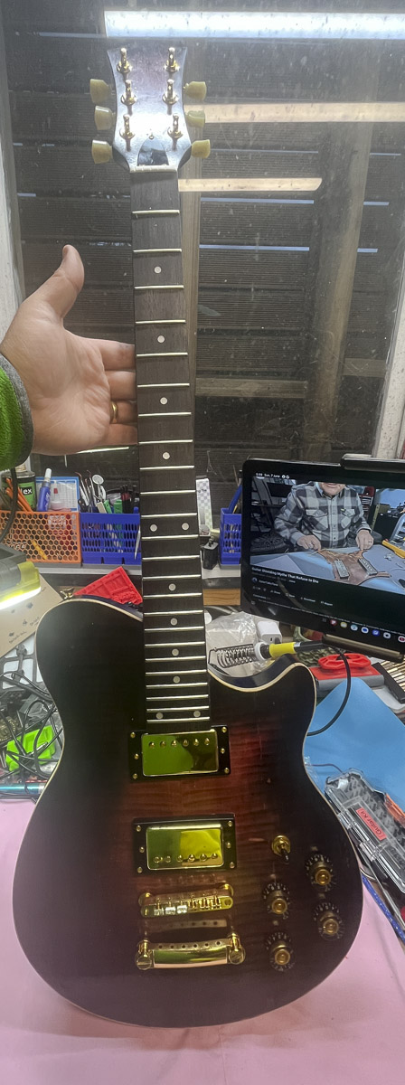

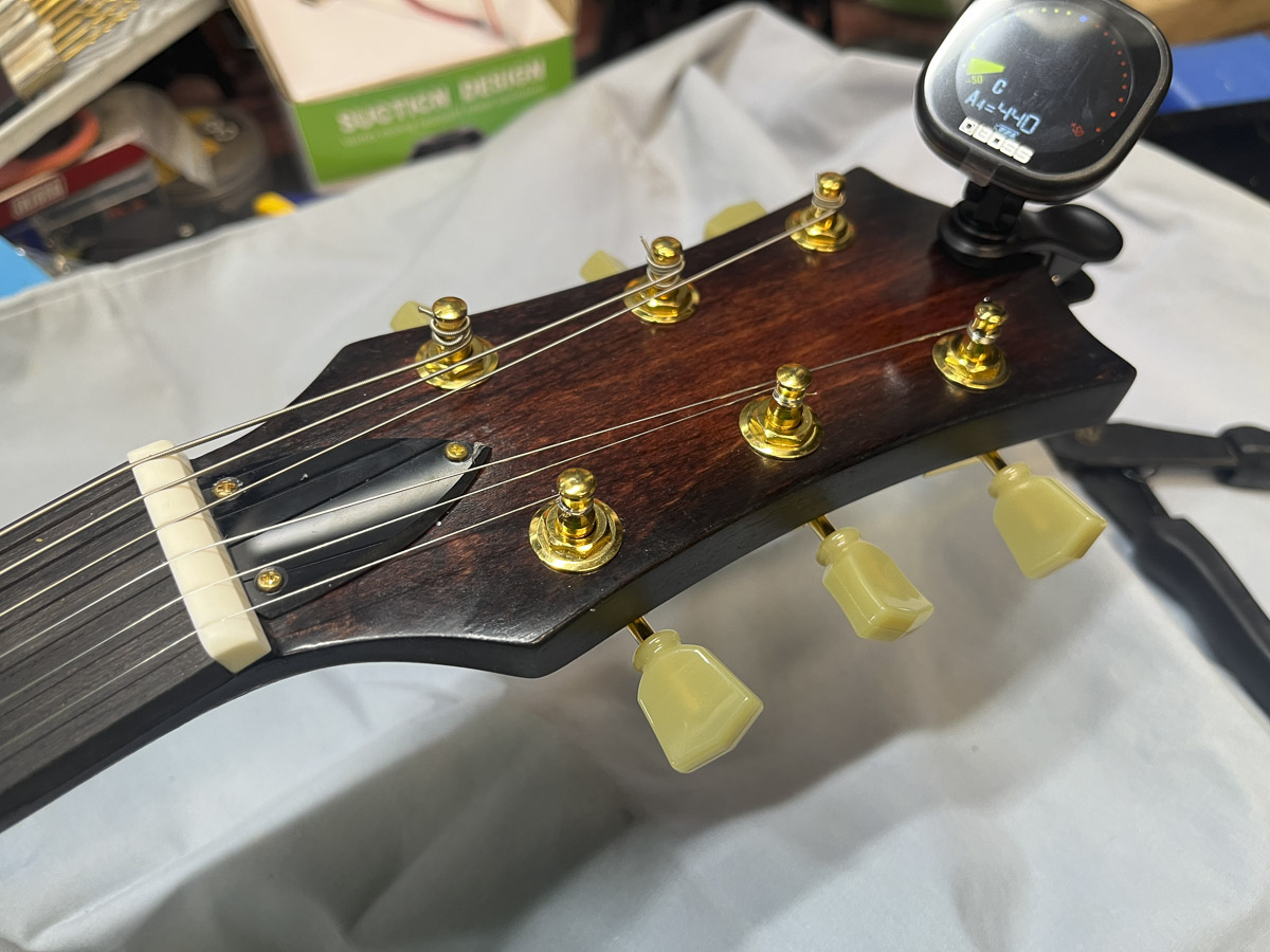

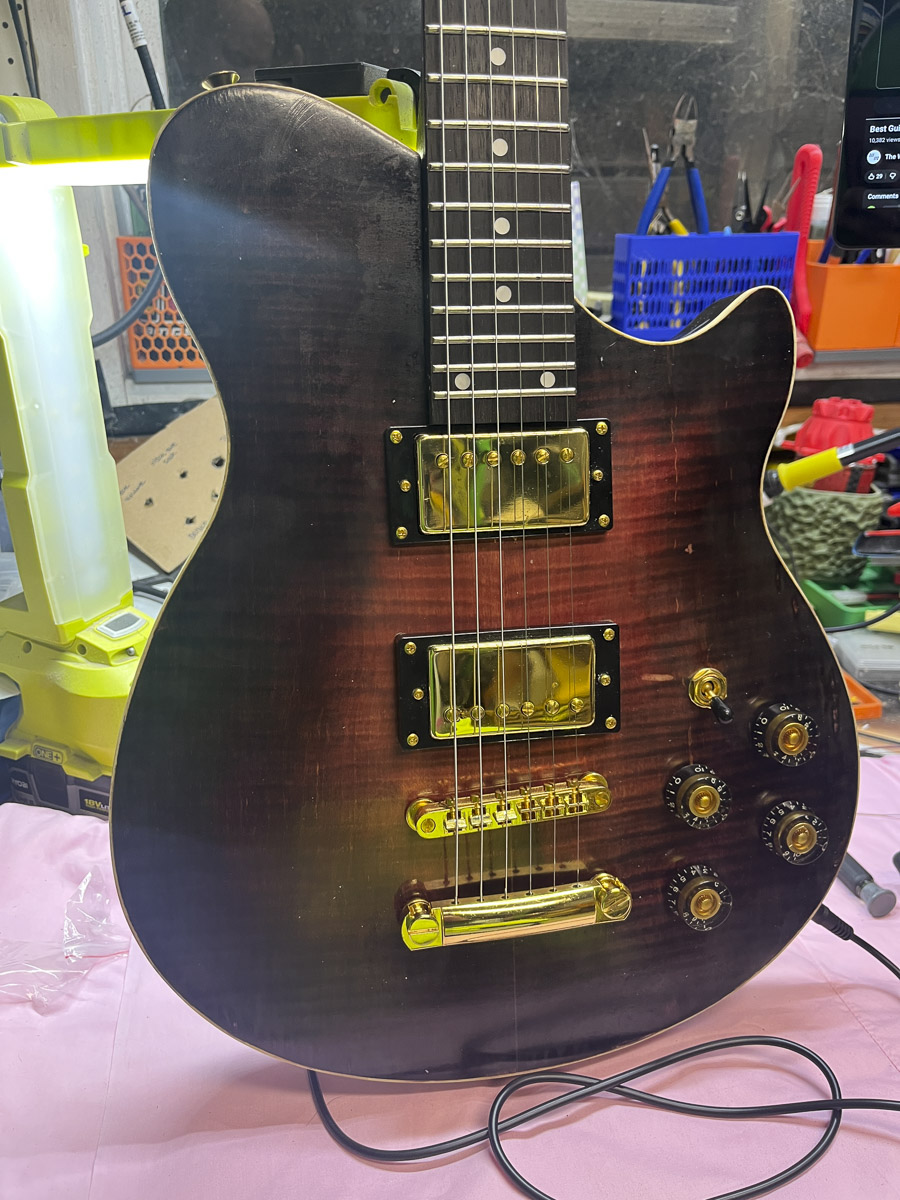

    Done and dusted! Well, except for a little tuning.
    Bit of time required with the multimeter looking for continuity and confirming all my parts were in order before getting it sorted out. Neck finish isn't too bad, I think i'd almost go for a thin satin finish in future as this finish feels a little slower. The grover winders are really nice and the bone nut feels more resonant than the plastic one that was originally on there.
    There's definitely something to be said for playing a guitar you assembled yourself. My son's been playing for a few years and he was impressed with how this one plays. I'ts got me interested (and now I've got the tools) to tune old acoustic that noone really enjoyed playing, i've got a 3D printed BC Rich warlock part assembled, a tele kit on the way and have rearranged a room to have a couple of guitars out all the time to practice.
    Appreciate your tips along the way, i think i'll be back again for another build soon. If guitars are like fishing rods, you can never have enough, even though you can only use one at a time!
