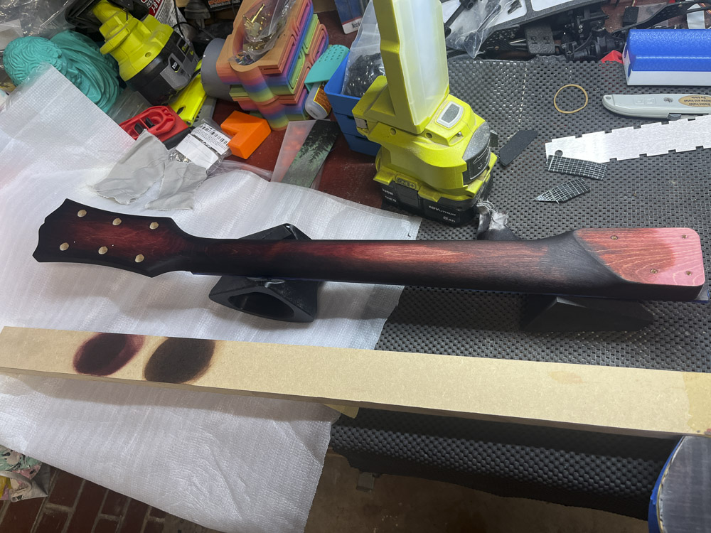

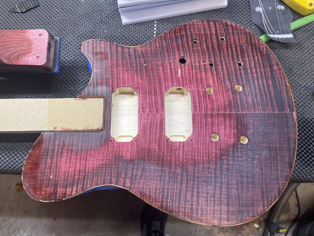

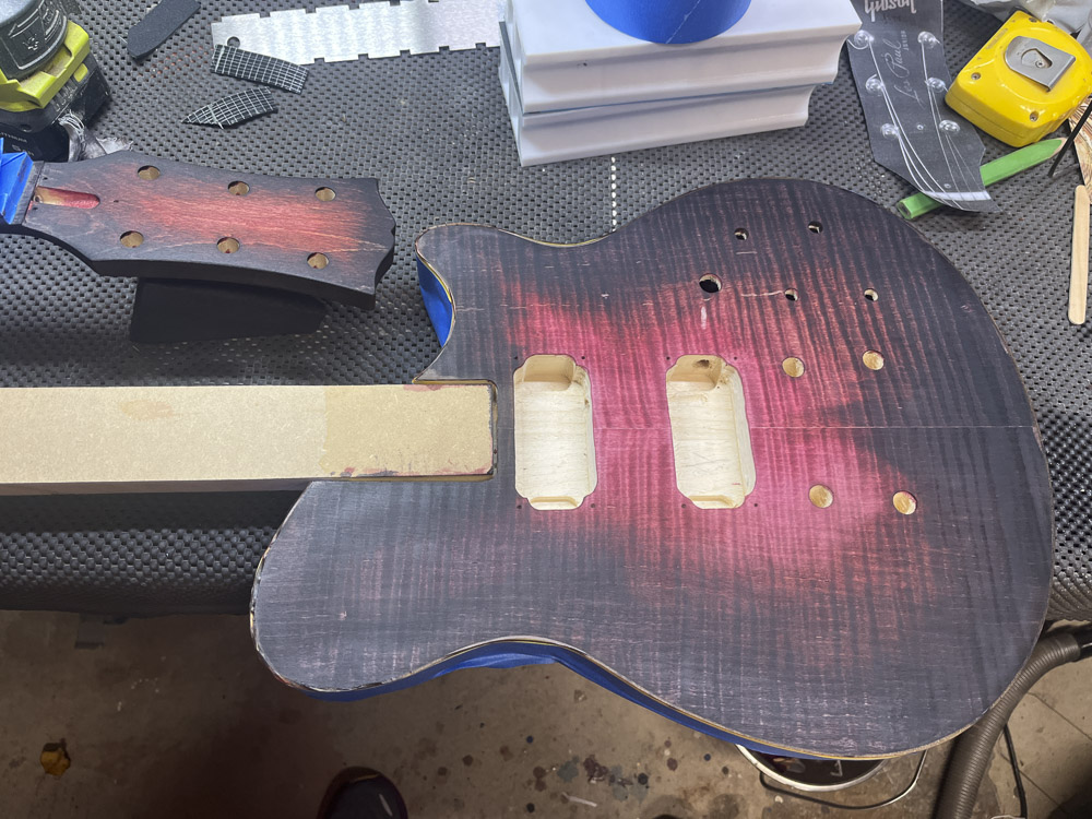

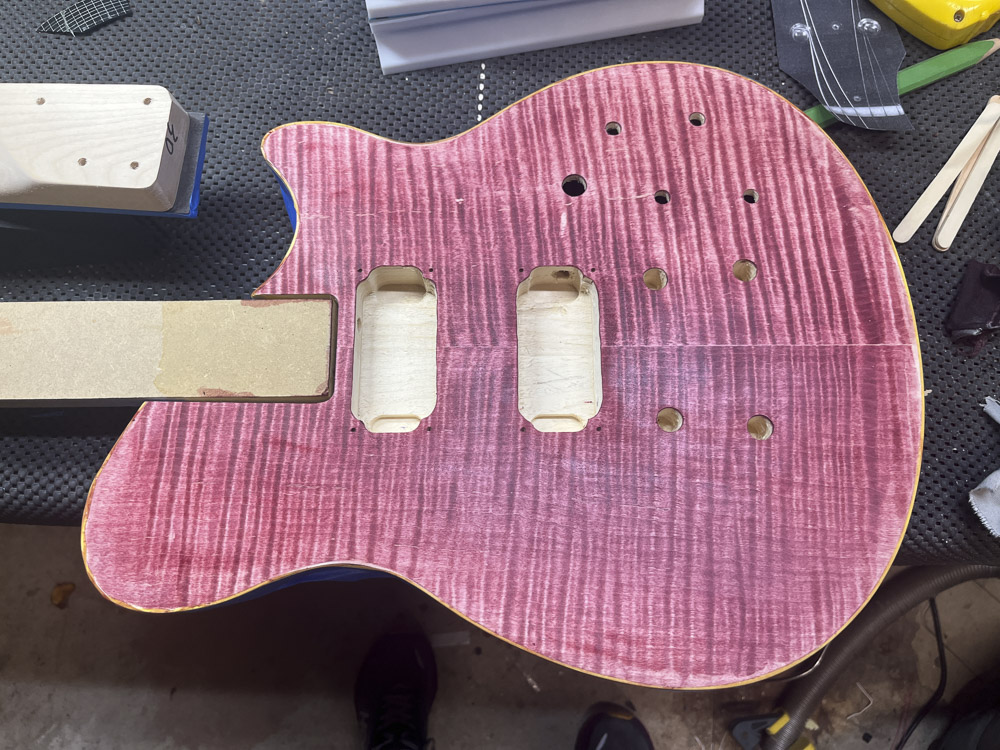

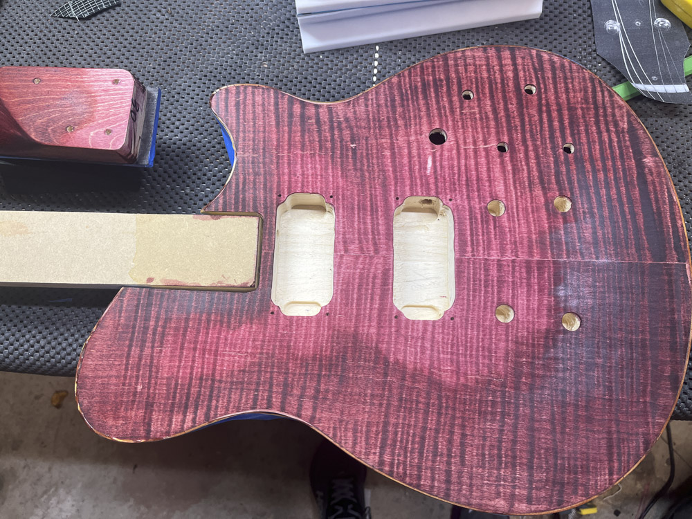

    Hmm, I made a note at the time of the scale length when doing a preliminary adjustment of bridge - I think it was 25.5" but will confirm if I get a chance to hit the shed tomorrow.
    Built up an oxblood sunburst (of sorts) using feast watson stains, starting with mahogany, then walnut and then black around the outside of the body.
    Applying the stain was a process of diluting the first coat with reducer and then progressively darkening with mahogany and walnut. Worth noting if you're going to try this approach for yourself on veneer is to not let any of the stain pool in areas (thinking you can rub out and disperse later). You can rub out and disperse, but not without soaking through the super thin veneer and into the paper backing which will bubble.
    Whole process took an hour or so of just creeping up on the tint and shading I was looking for.

    Good tips. Wish I could get Feast Watson stains here...
    I particularly like the burst on the neck.
