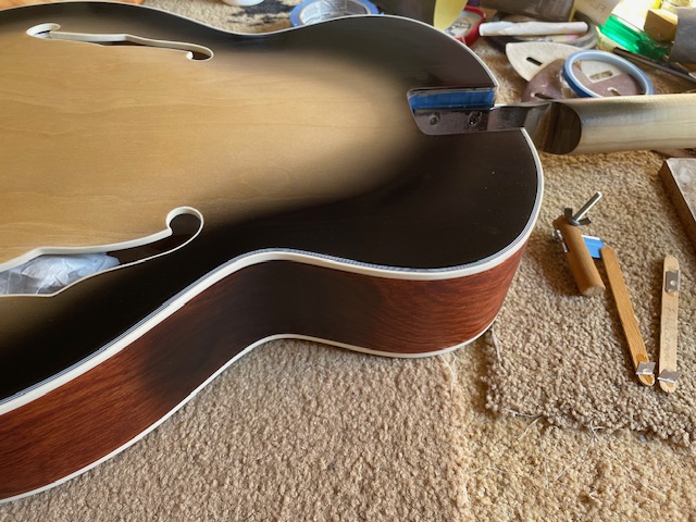

  5. #85
    1,967
    Today I have scraped the top binding and the f-hole binding to remove some of the polyurethane from the black burst. The f-holes have cleaned up well. The blades glued onto pop-sticks worked well as scrapers - I'm still impressed with them.
