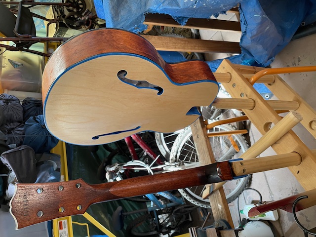

    Added a coat of FW Jarrah stain to the sides and back of the body and the neck.
ID:	46042   Click image for larger version.
ID:	46043   Click image for larger version.

    I have now also given the neck and body two brushed on coats of Tru-oil. Now it is time for scraping the binding.
