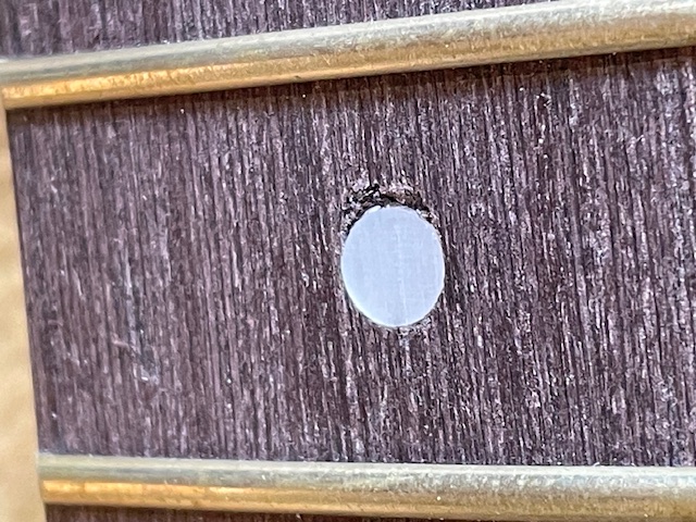

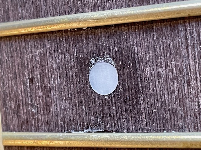

    Today I did the fret work - levelled, crowned, polished. Filed the fret ends.
    Also sanded the body and neck with 240 g paper. Taped up the body binding using 3M-471 vinyl tape and gave a coat of Ubeaut sanding sealer.
    The fretboard did have a couple of chunks taken out near the 3rd and 9th fret inlay dots. I ended up adding a few drops of CA glue to the hole and then scraped the area flat using a razor blade as a scraper.
