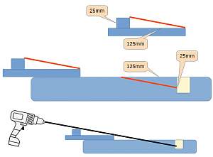

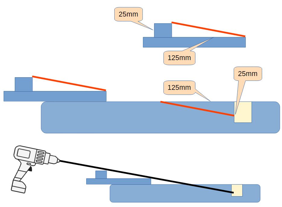

  6. #76
    2,986
    So this is what I am thinking that you use... Make a small block that is the same height as the distance between the top of the cavity and where you want the hole to come out. In this case 25mm. Glue the block to a piece of scrap wood so that the distance between the edge of the block and the edge of the piece of scrap is the same as the distance between control cavity and the shallow hole you drilled that will be under the bridge (in this case 125mm). Clamp the jig to the body so that the drill bit lines up with the shallow hole and rests on the jig as at the bottom of the drawing below?
    If that's right, it's ingenious. Quick, easy, no math...and it would work with any angle. I haven't seen this anywhere before.
