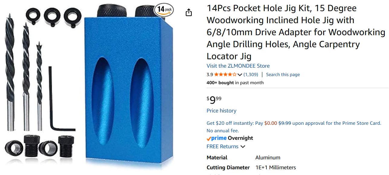

    I like it! Simple and effective. Do you know what angle that is?
    The angle is 15 degrees. This gave me a drop of about 10 mm into the body for every run of 40 mm across the body!
    I use a 4 mm drill bit.
    FYI - When I made it, I clamped 2 (Jig sized) bits of wood together, slightly staggered so that I made 2 jigs at once. The idea was to prevent tear out when the drill bit exits the first block.

    2,975

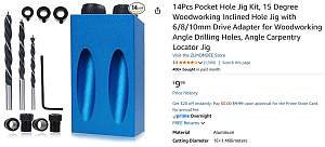

    I like this! Simple and effective. I actually bought a jig for $10 on Amazon with the same angle.
    While it's got the same angle, the smallest drill bit that it works with is 6mm...which seems a bit big to me. I have a feeling that a part of the excessive tear out that I had may have to do with using a relatively large bit. What do you think?
