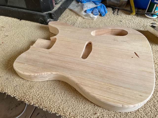

    The day started out pretty well. I had begun bolting things onto the bass. I got the tuners in place, as well as the pickguard and control plate. I got the bridge, neck and pickups aligned and bolted into place. It was going quite well, and I was starting to think I might all the drilling done today...when I realized that I needed to finish up in order to get to a meeting at work. I should have stopped there.
    Instead, I thought, that if I hurry I can drill the ground wire hole from the bridge to the pickup cavity...
    Attachment 46023
    I am not sure how I did it, other than the fact that I was looking at my watch rather than at the angle of the drill bit. The angle was, needless to say, too steep. To make matters worse, I not only botched the bottom, but cracked the finish on the top, when I tried drill a sallower angle to the pickup cavity. The only thing I could have done to make it worse is to have done it on a transparent finish. The solid finish is what makes this a setback rather than a tragedy.
    I made several mistakes. Obviously not being careful enough about the angle. But the biggest mistake was rushing. If I had stopped and returned to this when I had more time, I would have done at least three things differently. I would have been more compulsive about checking the angle. I would have sharpened the drill bit, which was clearly pretty dull. I would have just gone slow.
    The build will definitely slow down now. I put some wood filler in the hole. I put the wire in as well since once the wood filler sets, it may not be a hole anymore, and I really don't want to drill this again.
    Argh!!!!
  6. #56
    1,939
    Ohh bugger! As you said, just a setback and all can be fixed.
    Drilling the bass guitar bridge ground wire hole to cavity (either pickup or control) is a job I fear a lot. There is lots of room for setbacks. I feel your pain.

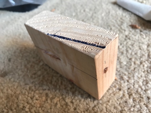

    I am going to start searching for a jig, to make this a little more idiot proof. Failing that I will attempt to invent one. I don't care how many 2x4s I have to turn to saw dust in the process.
  9. #59
    1,939
    I use a block of wood (with a hole drilled through at an appropriate angle) clamped to the body of the guitar. Basically, an angled drillblock.
