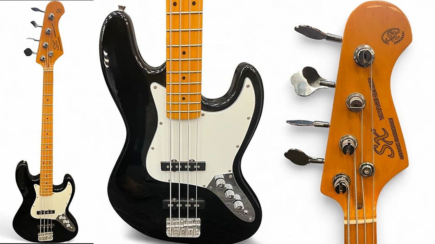

    A quick pause, to memorialize the "donor" bass. 19 years ago, I bought an SX bass--a Chinese-made bass from a Taiwanese company that sold exclusively through a mail order distributor. It was incredibly cheap, but well finished, played reasonably well, stayed in tune.... This is how it looked when it was new:

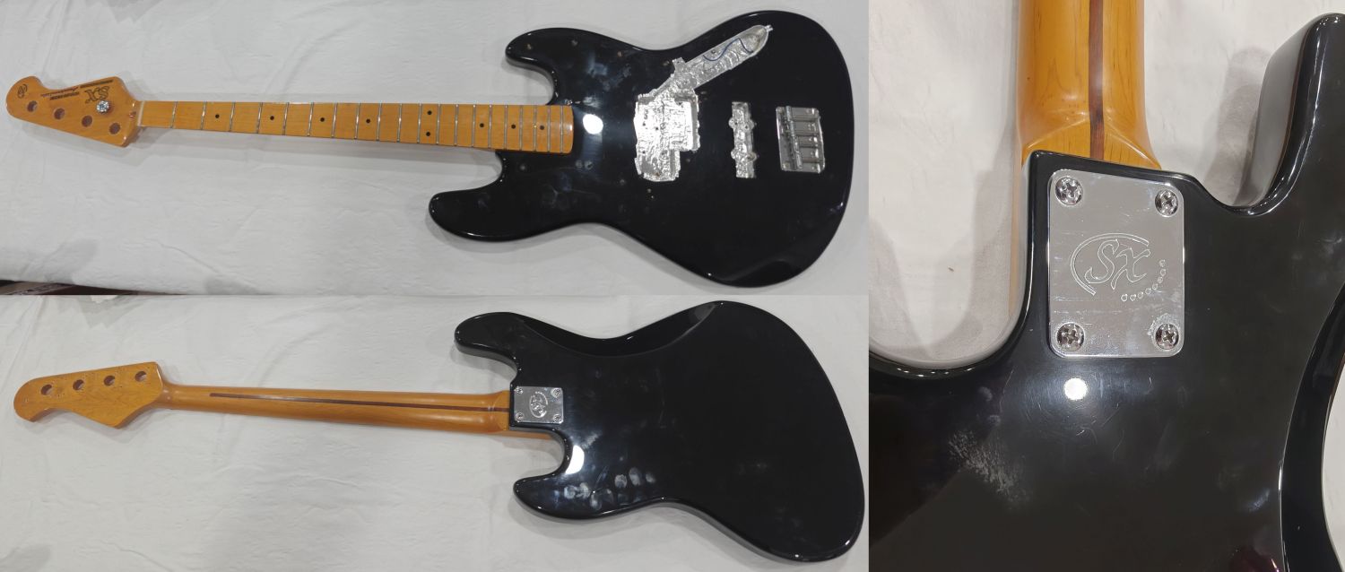

    Now it played well, stayed in position sounded good, and I continued to replace parts...but about 30 min to an hour playing it and my back stared to twinge, and sometimes my left fingers started to tingle. I really liked the bass, but it needed to lose some weight. So, I got a paulownia body and then I found a cheap neck on line...and the modded bass became a donor bass. When I took off all parts that I had at some point replaced, it left me with just the string tree, the bridge, the neck plate and its bolts.
    It's going back in it's gig-bag for now, although I have a plan, perhaps, to resurrect it... For now, though, I did not want to just put all the parts on a new body and neck without a reflecting on the bass they came from. I learned a lot from this bass. The wear on the frets is an indicator that it got played. It was ultimately a terrific bass that exceeded all reasonable expectations.

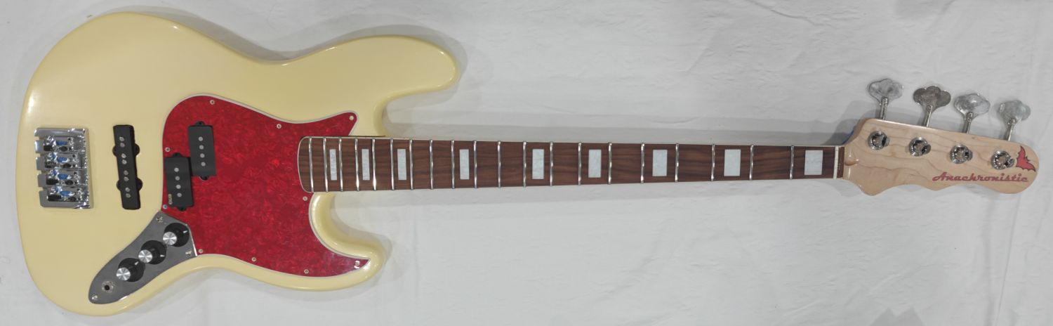

    I wanted to see how the PJ bass was going to look once assembled. Noting is screwed in, but this gives an idea.
    As the previous post implies, it has more parts from the donor bass than original parts.
    New parts:
    • Body
    • Neck
    • Sung Il high mass, locking Bridge
    • 3-String tree (not shown)
    • Strap buttons (not shown)
    • tuning post ferrules
    • Neck plate and screws (not shown)
    • LOTS of other screws (not shown)
    The J-pickup in the pic is from the original SX and is just there for the moment to help me line up the strings with the bridge and pole pieces. The bridge pickup is the EMG blue-taped into place for the same reason.
    I am just fine with a normal Fender-style bridge, but since the body is very light, the high mass bridge at the back helps to balance the neck. Also these Sung-Il bridges are really nicely finished.
    The SX had Schaller Straplocks, which I don't really like as well as the little rubber washers on a conventional strap button. The Schallers were clunky and overkill for someone who doesn't vaguely resemble Pete Townshend.
    My other bass projects have Hipshot tuners with screw on Ferrules, but these Gotoh's use press on. I didn't use the Gotoh ferrules on the SX because the orignals were nice and snug and fit the posts well. Meanwhile the Gotohs were slightly small for the hole. I have always wondered if there would have been a weight savings if I had used the Gotohs. The answer is "no." I have three sets of ferrules: the original Gotohs, a set that came with a PB kit and the original SX ferrules. The lightest were the ones from PitBull by about a half gram. The heaviest were the ones from Gotoh, by about a half gram. So I went with the PB's, although I am sure I would not have noticed the difference in weight--they also fit better than the Gotohs, which were a little small for the pre-drilled holes, just as they were on the SX neck.
    I got the Gotohs because they covered the screw holes when I pulled out the cheap tuners from the SX bass. I hate the screws, and they are a little heavier than the Hipshots...but otherwise these are my favorite bass tuners. They stay in perfect tune, and are silky smooth. I have tried Grovers, Hipshots, Schallers and Gotoh. The Hipshots are a close second, and lighter, but the Gotohs are the smoothest and most precise.
    A word on screws: After using several sets of Hipshot tuners that use just one screw per tuner, it is very clear to me that there is really no good reason why I should need 16 screws to mount 4 tuners other than tradition. This is particularly important because you have to drive the little suckers into maple. It's super easy to strip a head or break it off. Here is a piece of advice that I live by: To the extent practical, only use high quality, stainless steel screws. If there is ANY wear or tear on the Philips-head when you take it out, throw it away. When it comes to the tiny tuner screws, consider them "one-use." I do not use ANY tuner screws a second time. A few years ago I bought a box of 100 stainless steel screws in the proper size for tuners. Even though they are good quality they still strip very easily. That makes them a huge pain to take out later. In my case, the chances are very high that if I put it in, and took it out again, it may be damaged enough not to bear another cycle.
