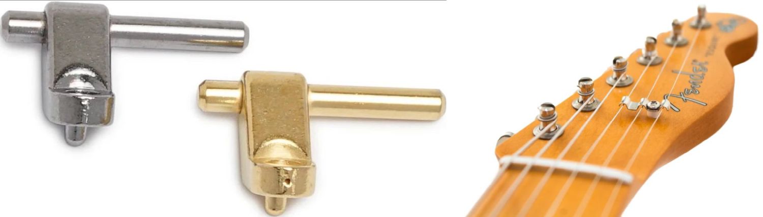

    Also, speaking of losing it... When I saw missing "ferrules" my brain glitched and went straight to "string trees"...which sent me to an image search. I think I had that on the brain because I just got a three-string tree for my Tele build. I got mine from Music City Bridge (the one on the left). My buddy has one of the other kind (on the right), which I saw at Solo Guitars in Canada.
    Apropos of nothing...just figured since I had the image on my computer, I'd include it in case you get the deadly G-string-jump with just one string tree ;-)
