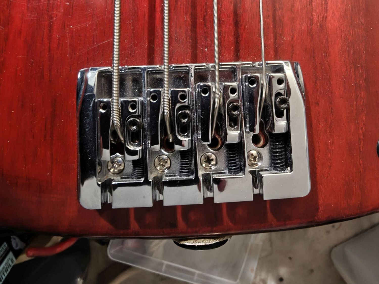

    Like TD said, almost all of the adjustment will be away from the nut on the E A and D strings (in that order). On my favorite 34" scale bass, the distance between the nut and the center of the 12th fret was 431mm. That means the "true" scale length should be 862mm. After intonating all the strings, the G string intonated at pretty close to exactly 862mm. I didn't have to move the G string saddle at all to intonate--and that is typical. Even so, I had it set back about 3mm from maximum extension toward the nut--which is more adjustment toward the nut than I needed. The E string intonated at 7.63mm farther from the nut than the G string. You can see the difference in the picture.
    In retrospect I probably should have set the bridge back another 1 or 1.5 mm farther away from the nut. As you can see the spring on the E string saddle is very compressed and would not have given me much more movement back if I had needed it. The great thing about these adjustable bridges is that there is enough adjustability in them so that you can be off by a couple of mm without too much problem.
