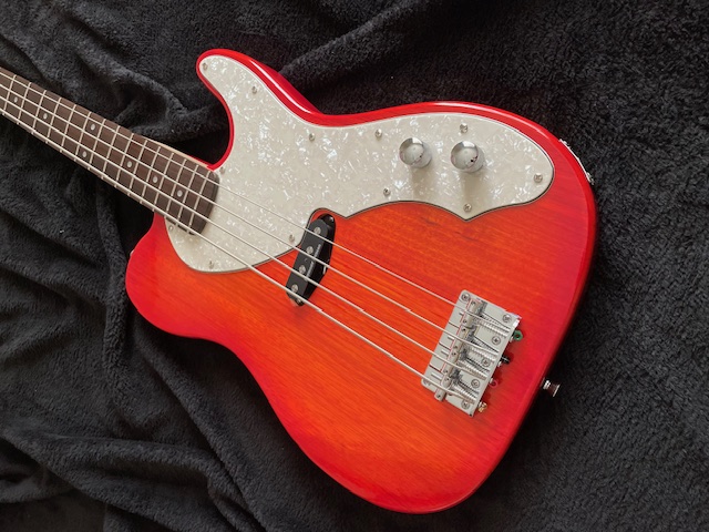

    Hi guys: Both your comment and Trevos Davies' have helped me a lot. The only doubt I have left is that you both recommend that to take the measurement from the 12th fret to the saddle, it should be almost at the end. Wouldn't it be more logical for it to be in the middle to have room for adjustment? Sorry for my ignorance.
  7. #16
    1,926
    Quote Originally Posted by Tino View Post
    To correctly intonate the strings it works out that the thicker the string, the longer it needs to be. This can be seen in the image below. The E string is the longest, while the G string is the shortest. On the guitar shown there is about 6 mm difference in length between the G and E strings.
    If you put the G string in the middle of the adjustment screw, then the thicker (D, A, E) strings will need to be further back. Then you run the risk of not having enough room for the E string. So, it is best to have the D and A string saddles about the middle of the adjustment screw.
    The annoying part is that the scale length is roughly the length of the thinnest string. Therefore, position the G string saddle to be further forward.
    I'm sure the saddle used in your kit is the same as in my picture - it has a lot of room for adjustment.
