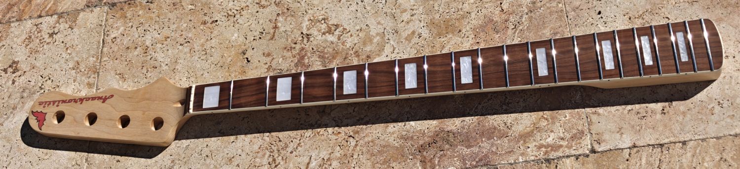

  10. #50
    2,953
    The bright spot in my polishing adventure this weekend was polishing the frets on this neck. It's finally ready to move from finishing to assembly. Whew!
