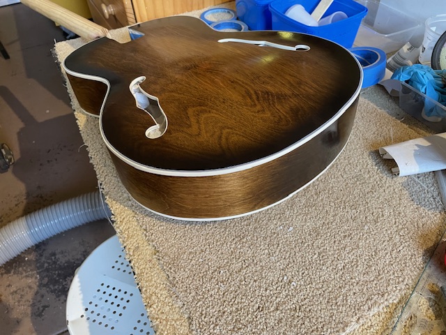

    Today, I have given the body and neck 2 coats of Tru-oil.
    After it was touch dry, I removed the 3M vinyl tape. I am very impressed with the results - hardly any stain crept under the tape.

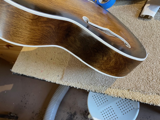

    Today I scraped the binding.
    Not much was needed with the side binding - mainly getting the Tru-oil off - using the razorblade mounted on dowel.
    The f-holes needed a lot of work (I should have used tape on them also). But they cleaned up well using box cutter blades which had been CA glued onto pop sticks. The 3 pop sticks had the blades glued at (very slightly) different scraping lengths. They still need a bit of tidying up.

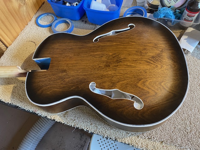

    The wipe-on-poly has had a few weeks to gas-off.
    So today, I have taped up the binding using 3M tape. I also created an f-hole shape on the Cricut cutter, roughly trimmed by hand and then taped up the f-holes.
    I have then sprayed a coat of clear water-based poly over the whole body and neck (which will hopefully fill any sections under the tapes), then sprayed a black burst around the front of the body.

  9. #59
    1,925
    Also tried some darker shading (not sure what this is called!) on the top, bottom and waist section on the sides of the body.
    A tiny bit of black got under the vinyl tape during spraying - but I now love vinyl tape for masking.

  10. #60
    1,925
    The body and headstock have now been given 5 sprayed coats of water-based gloss poly and the back of the neck 5 coats of satin poly.
    One lesson I did learn today - after getting dust falling onto the wet finish - is that the cavity needs to free of dust and binding shavings, otherwise the air pressure from the spray gun going into one f-hole will blow rubbish out the other f-hole! Live and learn.
