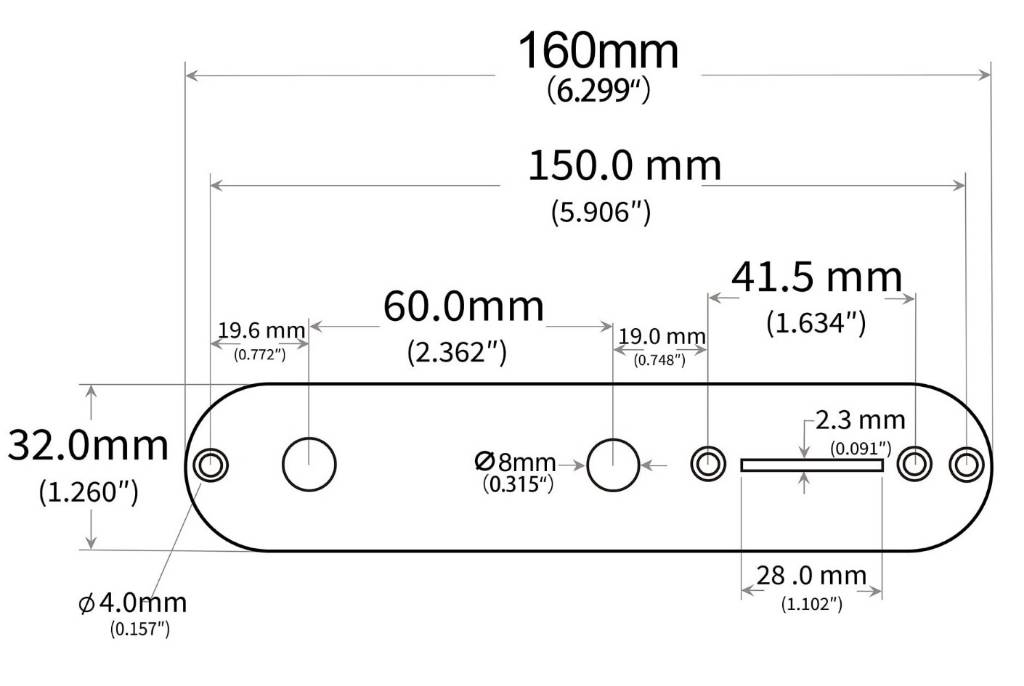

    I don't think the standard PBG TL-1 metal control plate will fit over the curved controls route on the DTL.
    Possibly:
    Trimming the "thinline" guard to keep the controls section only, or
    a transparent thinline guard (with a painted section for the controls area).

    I could be wrong, but it looks straight, albeit at an angle, in the pic.
    Easy to check. Here is roughly what a "standard" Asian-made control plate would measure.Click image for larger version.
