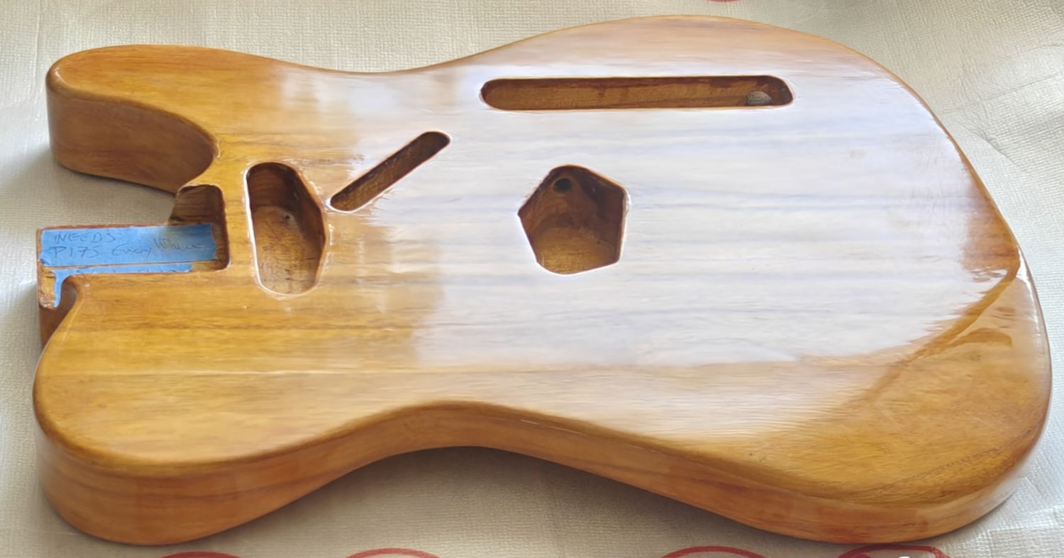

    Just finished polishing the body on this project. I am in a bit more of a hurry to finish my PJ Bass project, but decided to polish this body first as proof-of-concept before moving on to the bass. This one was finished with a clear that I will no longer be using.
    I started on this body using brown “tripoli” buffing compound, then moved on to Menzerna P204 (medium cut) and P175 (ultra fine). Here’s the result:
    So far so good. Leaving the neck mostly satin, but I did polish the headstock.
    I must say that I like this approach better than wet sanding and then hand polishing. It’s a lot less messy. It took me longer with the buffer to do the polishing than I thought it would, but I liked doing it better this way. I know there is danger of going through the finish while buffing, but I was pretty careful. Also I used only the P175 inside the horns because I was using a foam cone to buff with rather than the buffing wheel. I may use a little McGuires on that part as part of the final-final process.
  8. #77
    2,939
    I should add that I don't think the "Tripoli" was necessary. It may be a bit more aggressive than the P204, but I don't think it was actually necessary--and I have seen mixed reviews about whether it should be used on clear coat at all.
