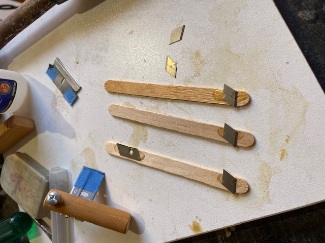

Today I scraped the binding.
Not much was needed with the side binding - mainly getting the Tru-oil off - using the razorblade mounted on dowel.

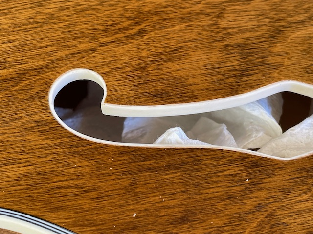

The f-holes needed a lot of work (I should have used tape on them also). But they cleaned up well using box cutter blades which had been CA glued onto pop sticks. The 3 pop sticks had the blades glued at (very slightly) different scraping lengths. They still need a bit of tidying up.
I am impressed by your scraping method. I confess that I have been cheating on my archtop builds. I did solid colors on the tops, and painted over the vertical surface of the binding. I only scraped of the horizontal part of the F-hole, and even then only where the 3M tape did not catch everything.
I am glad I waited to see yours before attempting a translucent finish. I haven't seen the popcicle-stick-scraper approach used before. What a great idea! I have seen the split-dowel-razor-blade-scraper, but even the DIY versions on YouTube don't looks as well made as yours. I wonder if there'd be a market for such things?
