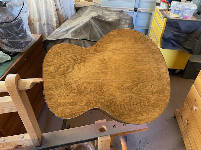

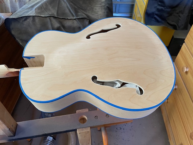

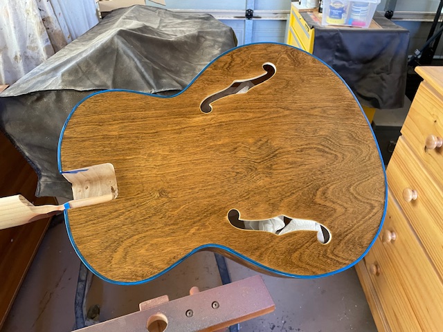

    Finally, I got around to:
    Adding some 3M-471 tape to the binding.
    Adding a coat of Ubeaut sanding sealer to the neck and body.
    Lightly sanded everything with 600 g wet and dry.
    Adding a coat of Feast Watson Teak Brown stain diluted to 50%.
    I'm hoping that the sanding sealer may have stopped some of the stain leaching under the tape. Fingers crossed.
