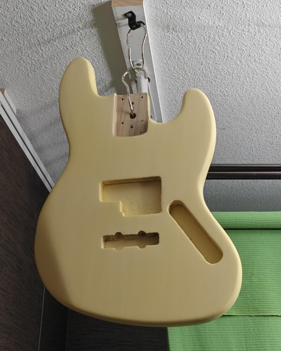

    I chose the color to go with the pickguard, but I hadn't actually seen the color+clear together with the pickguard until now.
    I sort of wanted to see how it would look with the rest of the hardware I plan to transfer from my old SX Frankenbass to the new bass. But that would be a fair amount of trouble, since it's all still attached to the SX. All I have taken off the SX is the pickguard, so that the bass is otherwise playable.
    The finish won't be hard enough to sand for at least another few weeks, but I think it's hard enough for me to begin some gentile attacks with a razor blade. I have used the taped razor blade trick to good effect in the past. Keeping fingers crossed that it works this time as well (although I admit it's hard to hold the razor blade with crossed fingers).

    The colour combo works really well. Good luck with the razor blade scraper - my favorite scraper.
