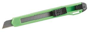

    I used one of these cheap utility knives that you get in paint stores for around a dollar.
    ...I also used 3M vinyl tape over the binding so that all I really needed to do was clean up.
    I use these utility knife set and the mini knife is mainly what I use if I haft to clean up the binding and I use 6mm fine line tape over it you shouldn't use masking Pape because it does a rubbish job, when your painting a body I will normally tape it up about 4 times to stop build up you can buy fine line tape at any paint supplier
