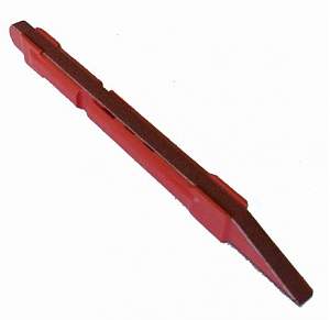

    If you do decide that you want to try to get that last bit out, you might use one of these on the 2nd fret:
    These are sometimes marketed as "fret dressing sticks" or "fret dressing tools" in places that sell to guitar people. The exact same item is often sold cheaper at wood working sites where it is called a "sanding detailer stick."
    Something nice about these is that you can use them to lower a fret just under the string that is buzzing without taking more metal off the whole fret. I have used mine on the low end of the fretboard when the fretboard is pretty much level, but I have a small, persistent buzz, usually one the 2nd or 3rd fret, and just one one or two strings.
