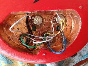

    we fit the strings and go to tune the Bass Guitar... and... no sound.
    bad wiring we will check up on the morrow.
    only sound from amp was when pulled the 1/4" TR cable out of the Jack. Massive feedback through amp, so at least the amp works...
    1,676
    If you cannot see the problem, post some pictures (closeups) of the wiring and soldering and we may be able to help out!
    For future reference - I would normally do a tap test with a screwdriver to test the pickups and circuit before I put on the strings. I use a battery powered "toy" amp for this test. That way I can problem solve issues while I'm in the circuit building and soldering mode .

    Reading other diaries for the IB-5, the jack connections often cause an issue! Possibly check this first.
    Apparently, the Pitbull diagram for the jack pin connections is wrong! See https://www.buildyourownguitar.com.a...l=1#post224011.
    Also, post https://www.buildyourownguitar.com.a...l=1#post211958

    thanks TC, we will check these out as is rather frustrating.
    we will attach a photo as best we can below.
    is very messy, we usually wire much better and intend to tomorrow as we desolder everything and start over again.

    howdy TD, we are experiencing the exact same problems as pappajer. he used the same wiring diagram that we used.
    we will do more searching as the information supplied to build this IB-5 is Incorrect.

    another problem we have is this mentioning of a battery being connected to the audio jack.
    we never came across anything that said a battery was needed.
    But, the Audio Jack in that Forum Entry is the one we have.
    https://www.buildyourownguitar.com.a...4&d=1620902260

    No battery is needed. The battery/power tab is to be left blank.
    I'm not sure, but the picture looks like the solder and pot legs are touching the copper shielding! If that is true it could be the problem!
