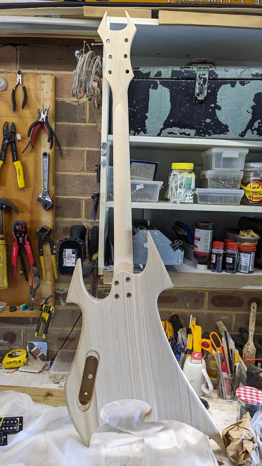

    30" Baritone guitar, the plan is to keep it fretless...
    After a quick dry fit, it all seems ok, except:
    # the neck pocket is a little bit abundant. First time I experience this on a Pitbull kit
    # the neck seems a bit "angled away from the body" (see photo below). Not sure, perhaps it's normal on this type of instruments. Haven't checked with the bridge height yet, worst case scenario the next will need some shimming.
    # the strings provided with the kit are too short (this is a 30" scale)
    # in terms of strings, I am doing some research, for 30" baritone some people recommend bass VI strings. Not sold on this yet, and lots to read about strings tensions and type of tunings... Standard B, or E one octave lower (basically like a bass)...
    # all the electronics came loose and will need to be soldered. I am not an expert but one or two bits and pieces seem missing to me (nothing major, like, there's no capacitor, and maybe something else missing, not a biggie though, could be fun)
    # advertised as ash, but it feels very light (again not an expert, but way lighter than the fretless PB4 ash I build some time ago)
    # the bridge pickup slots is slightly too small, the pick up fits "just", will have to use a Dremel to gently carve 1mm or so

    Nice pickup. I will admit that I was also looking closely at this kit!
    I think the neck being angled away from the body is to compensate for the high tune-o-matic style bridge.
    I recall that Simon B has mentioned the black ash versus the white ash. Black ash does has a lower density.
