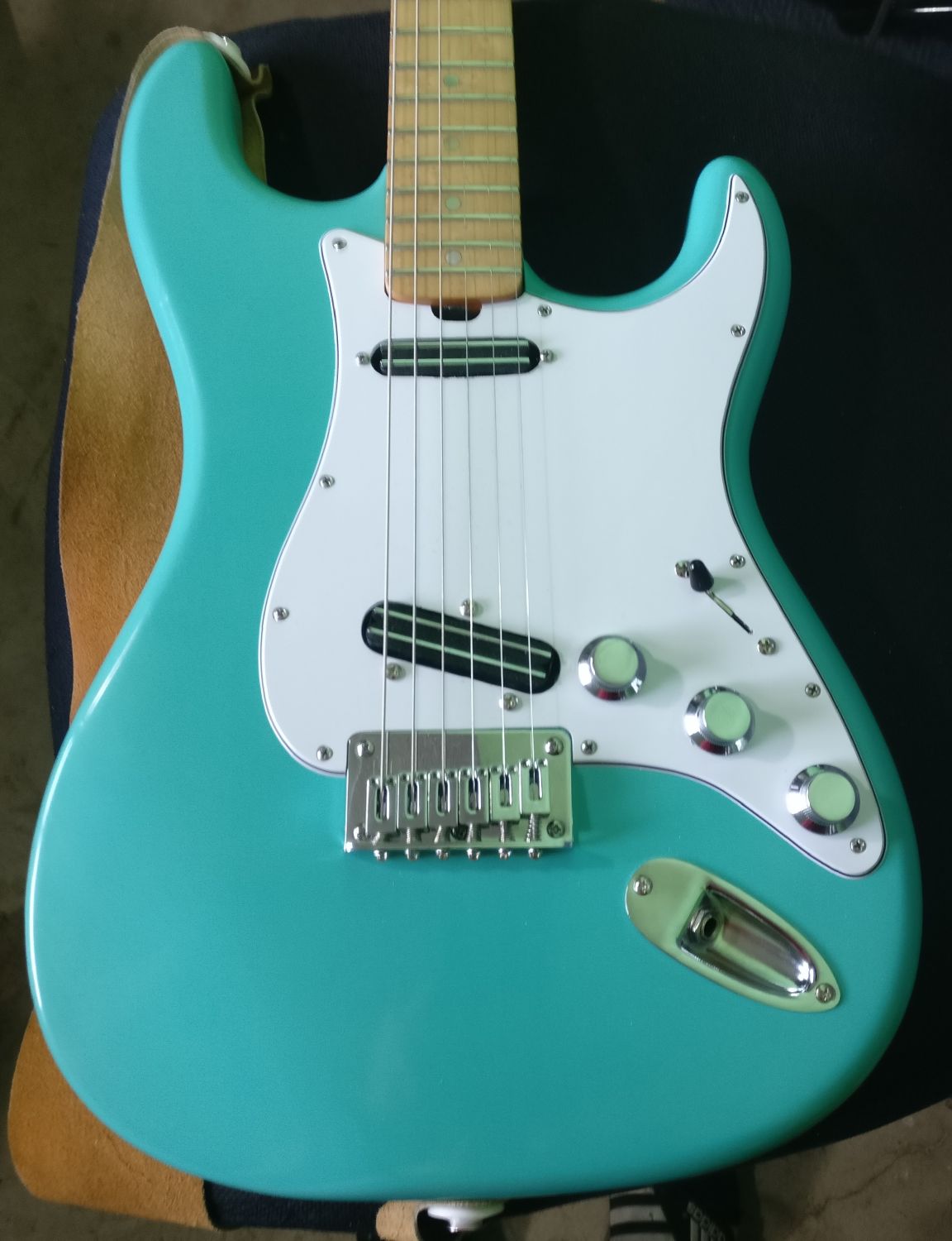

    I have also started to think about pickups. I have built more basses than guitars. So far, I've built just one guitar. My "aquacaster":

    It has a set of GFS Li'l Puncher Modern Vintage pickups... I am more of a bass player, and play guitar mostly for my own amazement, but I wanted this to be versatile. So the V and T controls are just like a Tele, and the switch is a 3-way Tele switch. The difference is the center knob, which is actually a rotary switch that allows me to select single coil or double coil modes. 1+1, 1+2, 2+1 and 2+2. I also added a push-pull switch on the tone control so that in 1+1 mode I can switch coils on the bridge pickup to get an "origial" and a humbucking mode. However, I rarely use the push-pull, and I never use the two middle settings on the rotary switch. So I could just as well have used a push-pull switch to put both in 2 coil mode or both in 1 coil mode.
    It has occurred to me that maybe I should put these pickups in a Tele body. I could leave the rotary switch intact and just use a stacked V/T... or... I could put in standard Tele V+T and with a push pull to switch from single coil to dual coil modes.
    Since the Strat body is routed for SSH or SST pickups...I could do that...or I could do a bathtub route and put anything I want in it.
    OR...I could leave the Telestrat alone and just build this one as a real Tele pickups with good quality single coil pups.

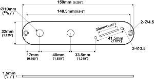

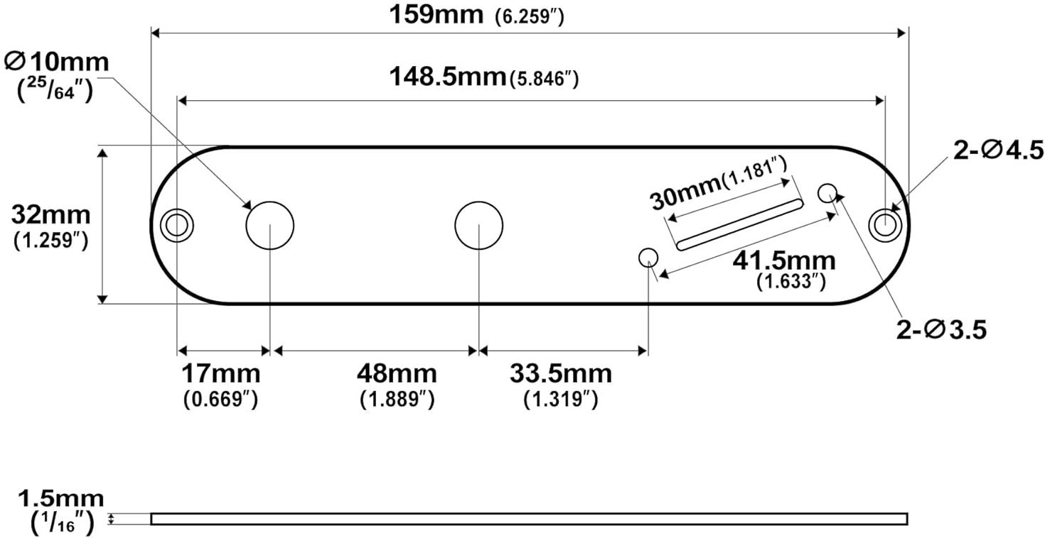

    First executive decision was to get a slightly modified control plate. I have found that the switch placement and the volume control placement on the "Telestrat" above are what bother me most about it. I am getting used to it but it's easy for me change hit the switch while strumming, particularly when it is in the neck pickup position. A lesser issue is that the volume control is so close to the strings that I can accidentally change the volume as well. I am guessing I'll continue to get used to it, but did not want have an issue with the controls on the Tele. I have heard that the switch in in the neck position is so close to the volume control that it can be an issue for some people. This control plate moves the Volume control back a bit, and angles the switch to avoid that problem...at least that's what I have read! Not sure if the OEM control plate would bother me, but an ounce of prevention... (30ml of prevention...?)

    I like the idea of the modified tele' control plate (& I may look into it down the track). The strat volume control is too close to the strings, and the tele switch is a bit close to the volume.
