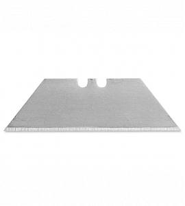

    @fender3x Thank you for the details. I did check the guitar after 5 days today. The drip bubbles are still not dry. The nail indentation test is positive. Should i start only when the drip is rock hard? I don't know. It may take a couple of weeks I think. My hands are itching. Should i take it from the bathroom and keep it in the sun to make it dry faster?.
    I checked on the methods. I can try the first method, I have lot of timbermate left over. I can try to use that instead of drywall compound as it cleans up with water well too. I did check out a video on Highline guitar youtube channel.
    I can try the razor scraping method too. But in india the razors blade look very different from razor blades that are available in america as I see in videos
    Do u think I can do it with ones available in India?

    With regard to the razor blade. I was definitely referring to the "American" type. We have what you call the "Indian" type too...but only for shaving. I would worry that it might be too flimsy for this usage. If you can't find the American-type razor blade how about a utility knife blade?
