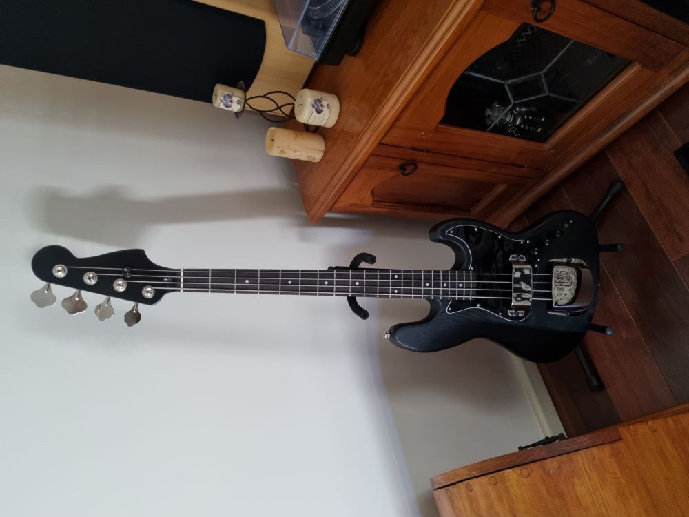

    Hi Paul, I just finished a JBA 4 Ash, with a few variations to the kit hardware. It's quite impressive, or so I would like to think, but as said, it is quite heavy in comparison my Pbass, which, I have not yet identified as to what wood was used but quite a lot lighter. Click image for larger version.
Name:	completed Ash Bass.jpg
