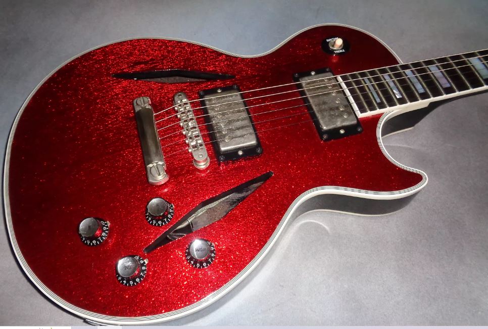

    i havent been able to find one and especially by an Australian builder if it were to be a kit i would give it a 6 inline headstock and diamond fholes similar to this guitar
Name:	les paul idea.JPG
    Quote Originally Posted by bar0065 View Post
    I would love that but only if it were to come with a back cavity access because threading electronics through f hole is tough even in bigger Es335 body, les paul are much smaller and it would be a pain
    i beleive this guitar hear uses a standard les paul back plate
